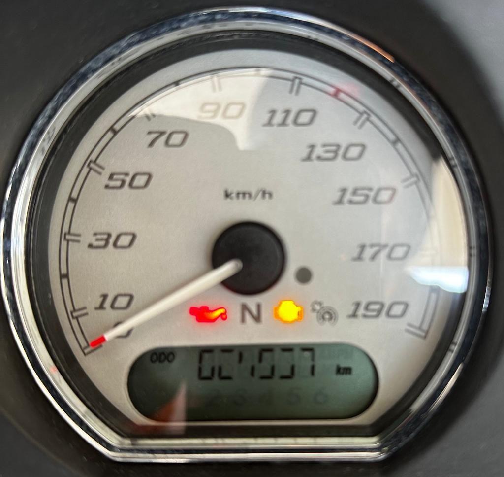

Hello everyone
My bike is HD Street Glide FLHX 2019.
I have an issue with the kilometer digits on my odometer. They are not shown completely which means that some “dashes” are missing. Upper right dash and the middle one is missing on all digits.
Please see the photo.
The gear number is shown correctly.
Does anyone know what this could be related to and could it be fixed without buying a new odometer?
Is there any service manual for download for my bike which can help me get to the odometer?
Thank you 👍🏻

I believe these are not repairable. Buy a new one. I had to do this on my 2018 Heritage.

Agreed, when the digits are broken it's usually a sign the voltage is low or the device is on its way out.
Check the battery and check/clean the plug, both ends.

It's likely a dead circuit in the LCD or LCD encoder. It can be fixed by a skilled electronics repair technician, but you're probably better off just replacing.
