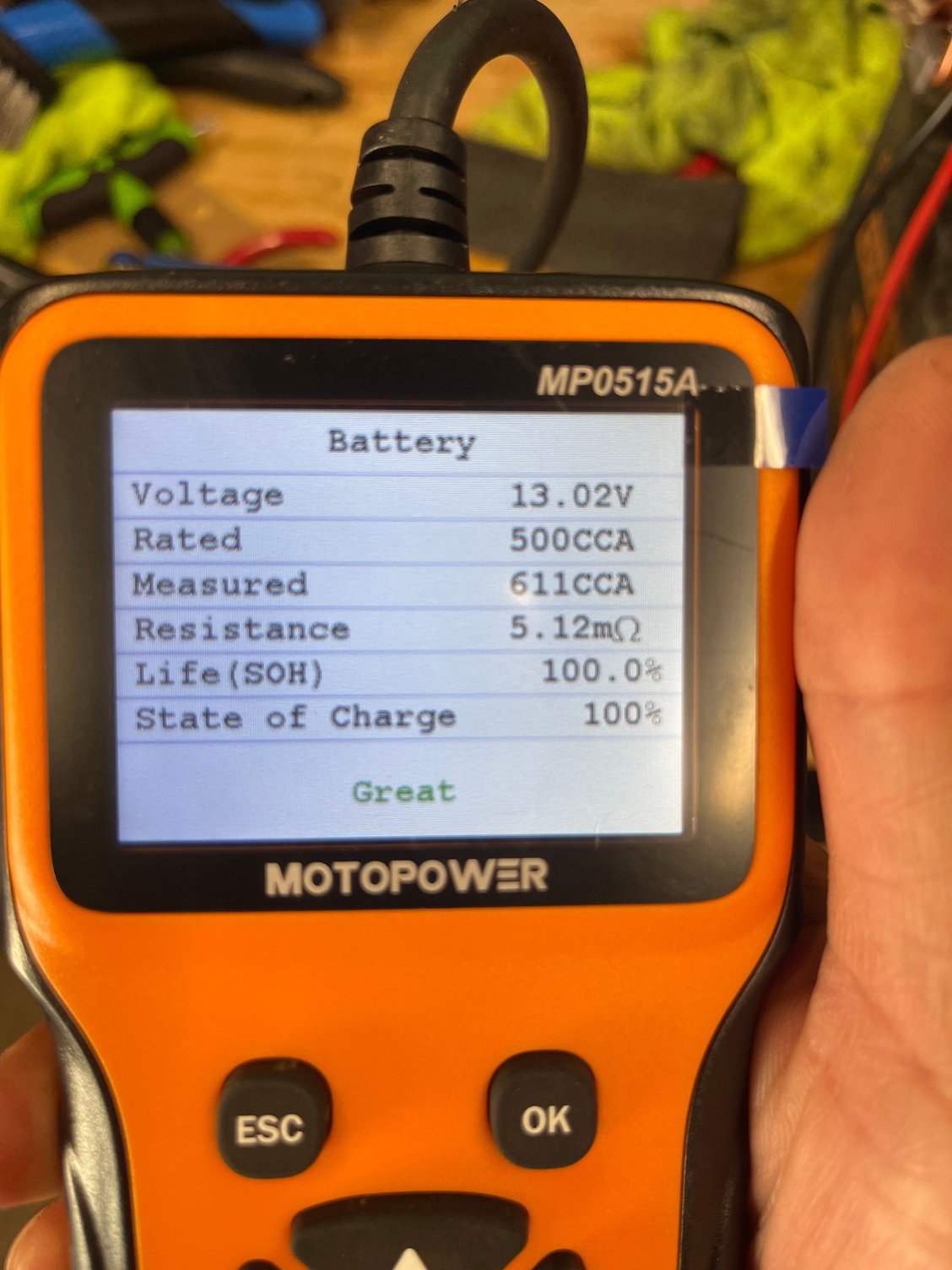

I left the battery on the charger last night. Here’s the readings this morning. I’ll put it in the bike and do a start test this afternoon.
A posters commented on the internal resistance on the battery which is shown here. I don’t know what is good.

It is a year and half old battery, I understand the guys apprehension about chucking in trash. They are not cheap
If it starts fine with jump pack, or charger on high, I generally will say bad battery. Not that it can't be dirty connections.
But didn't he replace battery and all good? So many battery threads hard to keep track
