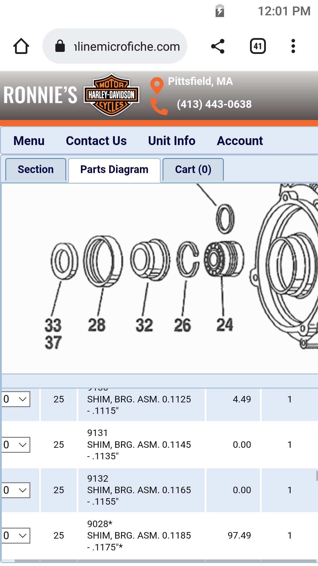

Was the shaft really driving or just turning from friction. Can happen if the drive key sheared.
What did the spacer look like that runs in seal in primary. It's very possible it has a groove. Seal rubber can get imbedded with dirty oil and groove. See that all the time in crank dampers on car motors.
There even SS sleeves to repair them. The TC one can be 180 turned for a new area. Yours can't.
