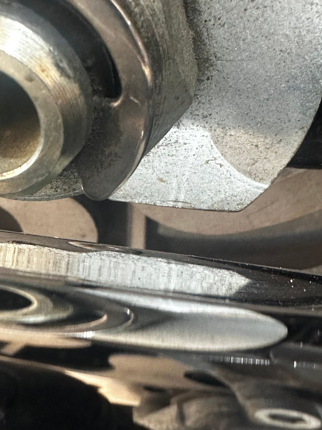

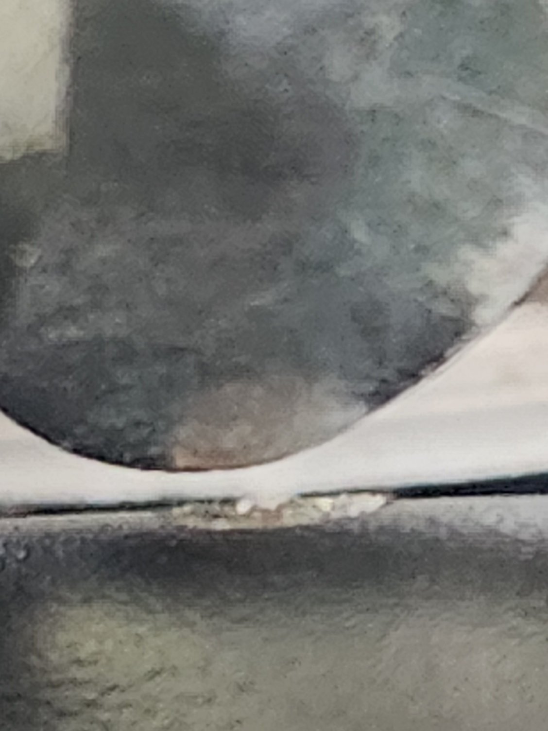

2020 Ultra S&S GNX. Belt tensioner cam plate hitting the muffler. Loosened up the bolts and muffler clamp but seems to be no adjustment to clear it. Left side has about 3/16 of a inch or so clearance. Anybody have this issue with S&S?
In before somebody says, “Why, I didn’t have any trouble with mine at all."
As I recall, when I bought 4.5" slip-ons, I noticed that Rinehart doesn’t recommend theirs for certain baggers. Same issue. So I put Khrome Werks 4.5 cans on mine. Ran into the same issue you have. I loosened up the exhaust system after taking the right slip-on off. I beat a dent in the right can with the round end of a ball peen hammer right where the adjusting cam was hitting it. Put a thick rag, like terry cloth towel overy the muffler so you don’t mark it up. Just a slight dent. Invisible once installed.
One thing you'll notice, if you have the sag adjusted on some aftermarket rear shocks, when you drop the bike down off a jack the sag will help your mufflers clear the adjusting cam. Now unless you get “air” occasionally with your bagger, you won’t have any trouble.
Edit: Another thing I did was put a couple of washers between the right slip-on and the bracket so it drops the muffler down just a smidge. Completely un-noticeable. Don’t use more than one or two washers for each bolt because you’ll run out of threads on those two 1/2" inch bolts and can strip out the brackets that are welded onto the slip-ons. I didn’t do this thankfully, but I noticed I was running out of threads, and fast, if I put too many washers between the muffler and the bracket.
