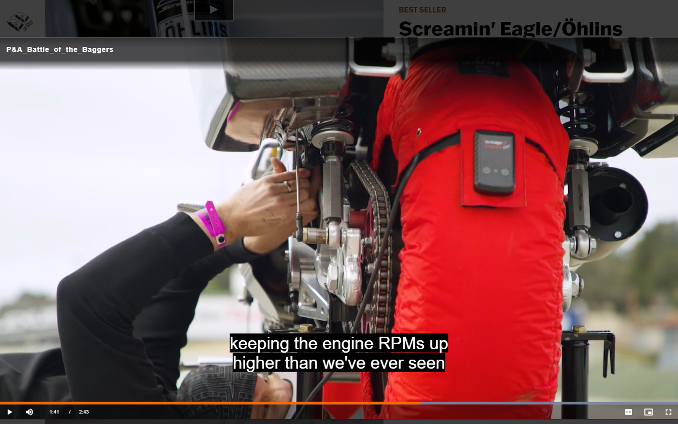

So what are you saying? Jump now or wait until the economy collapses? (as if I weren't indecisive enough) LOL! Meanwhile? I sure have learned a bunch about the offerings out there but possibilities are still ranging from bottom line Bitubo Twin Adjust VS Ohlins Blackline 777's to Progressive 944 VS 490 Sport shocks and from there? The Mac Daddy. The pair of SE Ohlins that are sitting at my local dealer 15 miles away that I can hear calling my name from off in the distance for the past 2 days now but I've been able to resist temptation thus far however?
I did look into the SE Ohlins because I was curious why the parts guy couldn't give me a spring rate/weight value on them and I'm like wth? it's not marked on the package? and nope. He couldn't find the spring rate anywhere so it took some research on my part but I did find out why that if I ordered Ohlins HD 044's from Ohlins they come with very rider weight specific straight rate springs for optimum performance but the SE Ohlins come with progressive rate springs to accommodate a much wider range of sag requirements.
One things for sure, The SE Ohlins ain't nothing like what's being run on the tracks...
