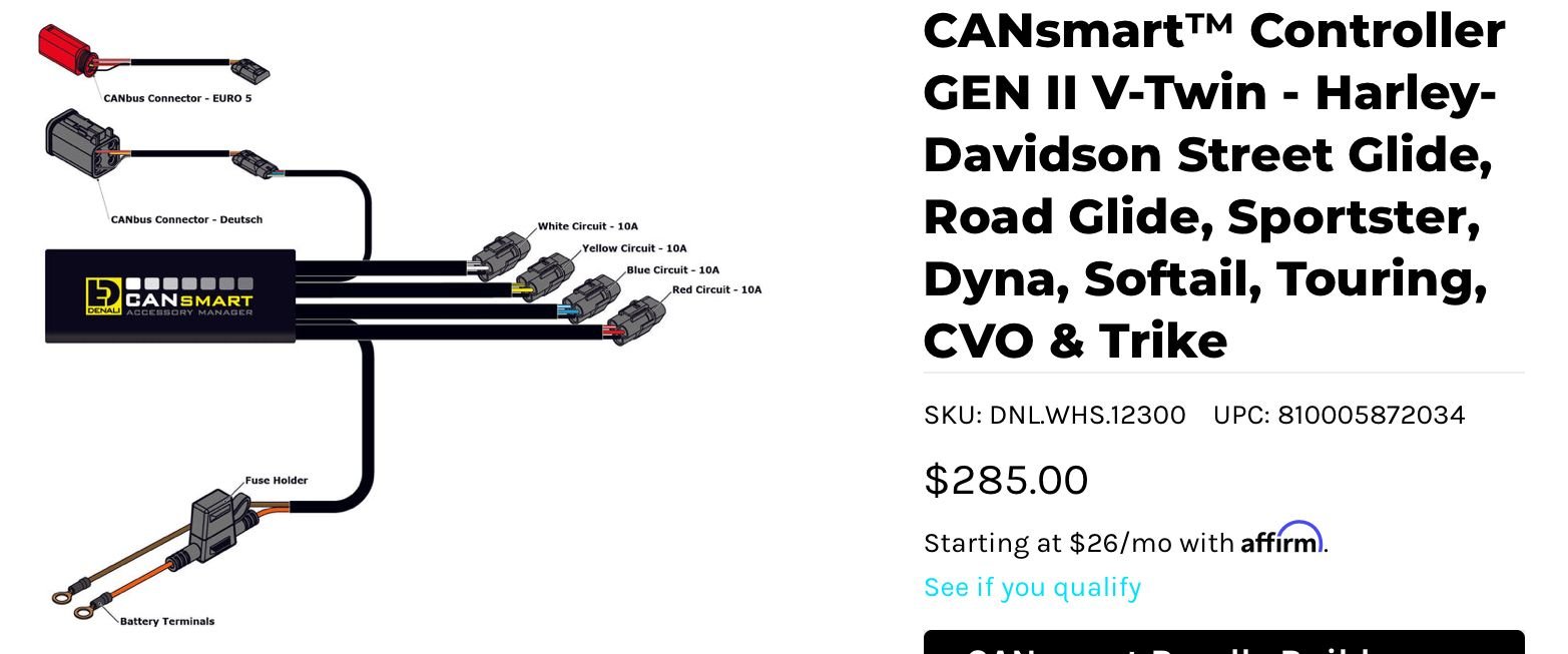

You have to look at the site to see the incredible amount of functions this controller has...
www.denalielectronics.com
