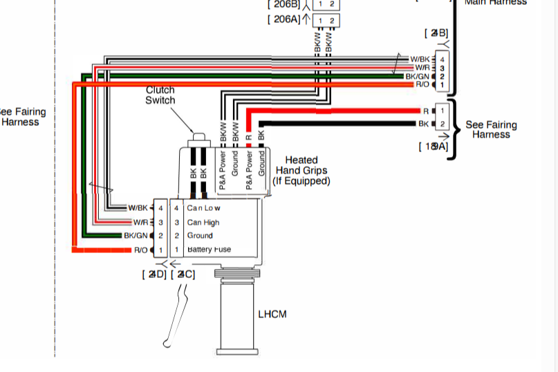

Checked the heated grips and they don't get hot so it's time to take things back apart to hunt for the other end

@Diesel X I think the connector you showed in the first post may be for the Heated Grips.
The confusing part is the blank accessory connector looks like the grip connector and probably the power outlet connector too.

Looks to be for an accessory. The wire looms are standard. 1 loom fits all in a frame family and all markets. So, it could be for something that is an accessory in Austrailia, but not legal in North America. Or, vice versa.

Found the other end. It was the red and black wire for the heated grips. Confirmed they worked before putting everything back together
