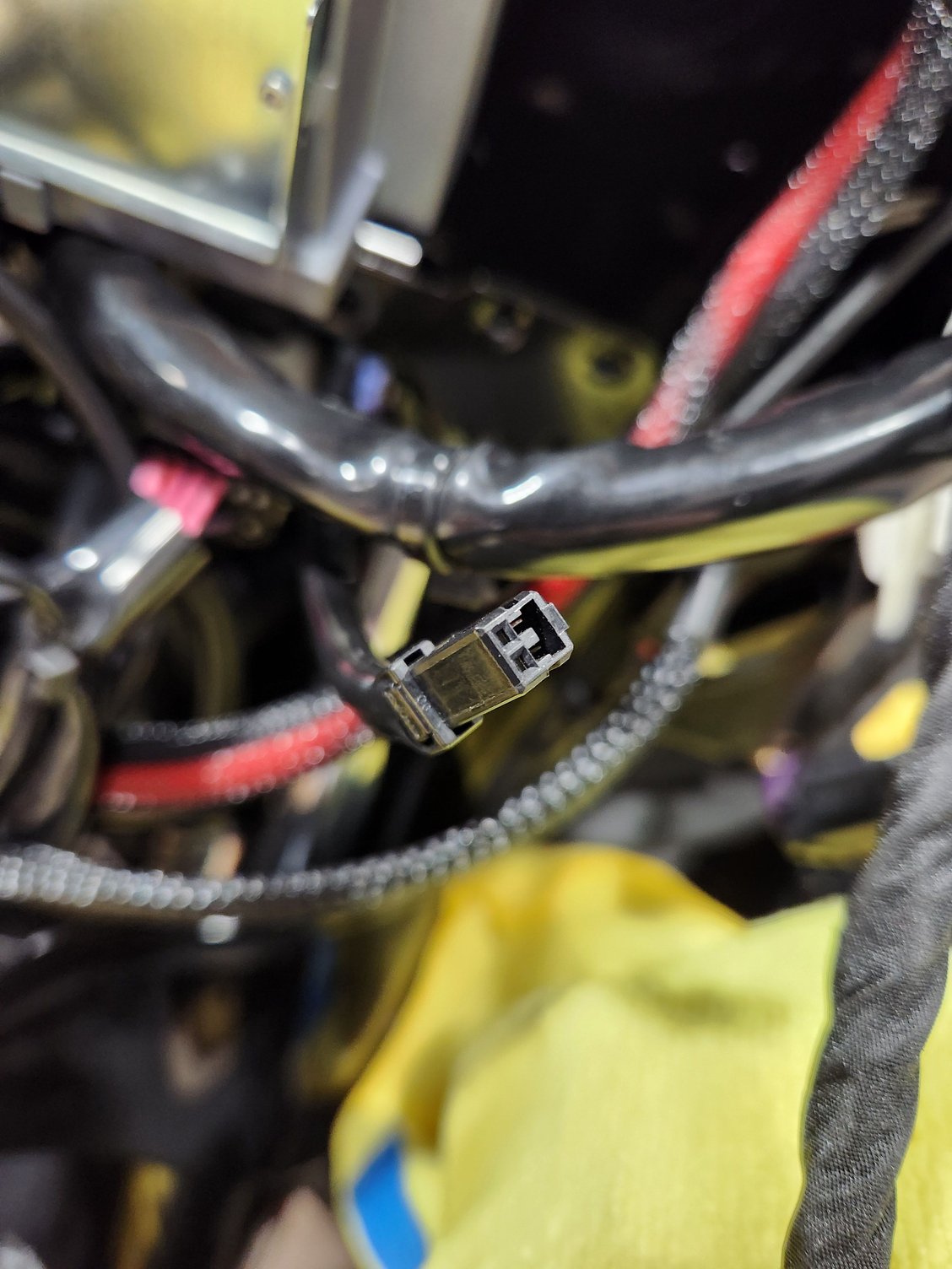

In the process of finishing up the wiring for my audio upgrade I can't figure out what this connector goes to. Left side of bike. Appears to be coming from the wiring harness under the plastic tray that's under the radio. Violet with blue stripped wire and black wire. I think it may be a accessory wire not used but has no but cap. I can't find any other wire wit in the short span to connect to it. Any ideas?

Accessory to tie in for remote on for the amp. HD makes a Y connection so you still have the accessory available. Double check in the audio section for sure. Would also help to list year and model of bike.

2020 flhtk. Kinda thought maybe it could be a accessory wire. There at least 2 others in there that are the same size wires but for some reason this is the only connector with no butt cap. I did use 1 on the right side for the amp trigger

All good. I missed the "left side of bike" in your original post. Now that I think about it, are you saying left as in looking at fairing from front of bike or left as in rider position clutch side? On the RG the connector is on left side from the front or brake side.

Power for heated grips?

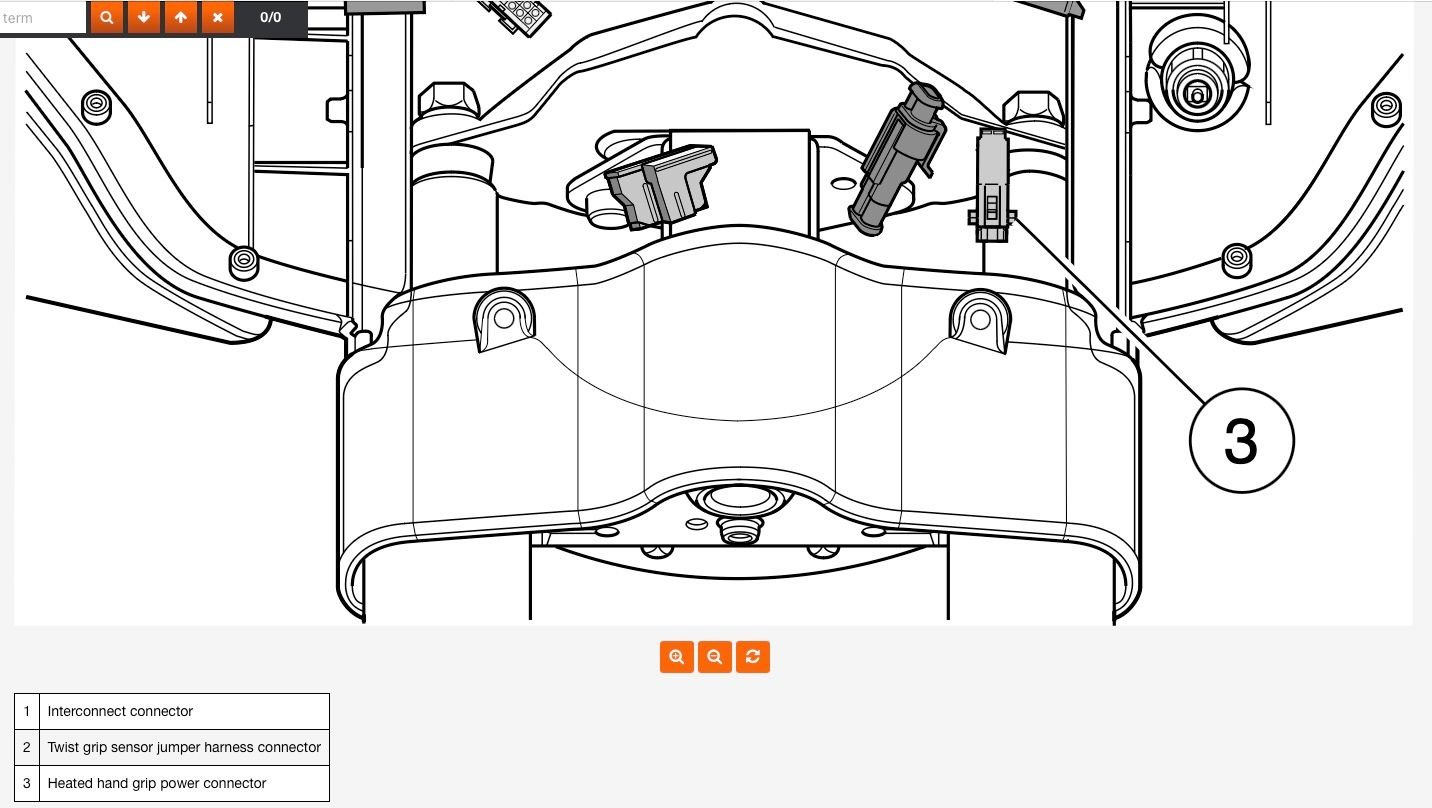

Is it number 3?

Clutch side. No not #3. This is higher up just under the radio tray area. I have heated grips but haven't had a chance to put the main fuse back in and start checking what works

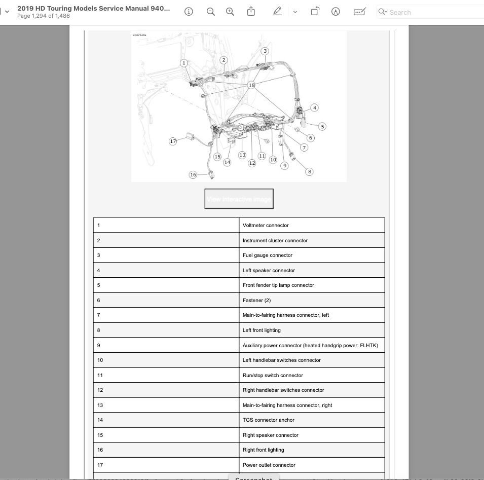

Looks like #9 in the diagram. Can the heated grips work off the accessory switch. My tank is off and don't want to pressurize the fuel system or worry about the pump. Just want to see if they work before pulling it back apart to find the other end2
Yes, the heated grips work when the bike is in ACC.
