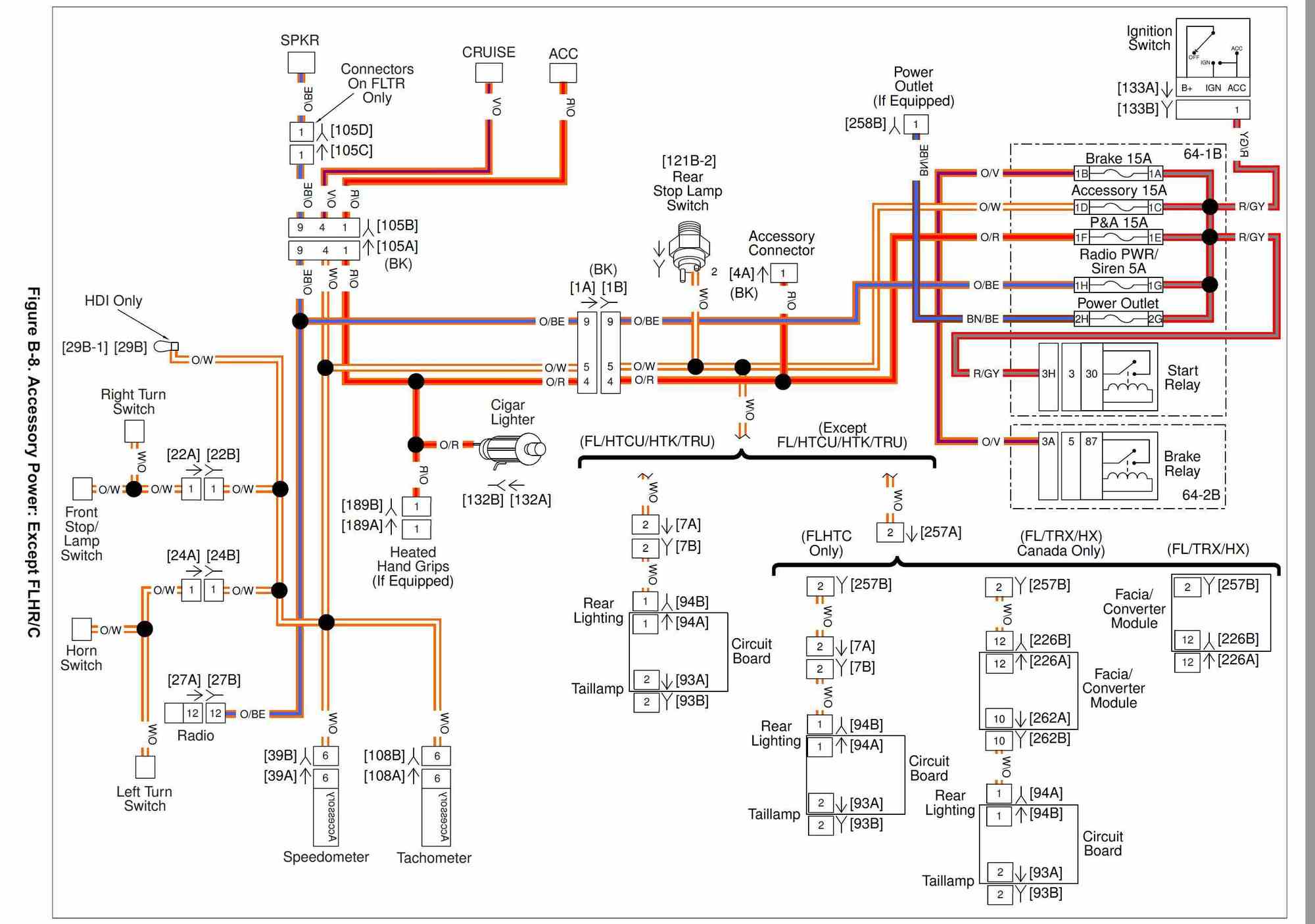

Yeah about the pining of the voltmeter but if the accessory part of the switch is flaky, the radio, cig lighter, instrument lights and tail lights won't work. You are supposed to know wiring diagrams. Go look at what the accessory stuff powers. The ign switch powers 2 things when bike is on. Figure it out and get back to us.

OK Broken ground wire in the main harness at the neck.. What are the miles on the bike?

If the ignition switch is flaky and the power to the Accessory wire is lost, you can see from the wiring diagram all the stuff that loses power.

And the bike will still run..
