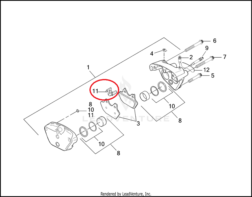

My bike when front braking which I do very seldom, sounds like a dump truck. Pads aren’t worn, anyone here ever experience this noise?

1. Remove the caliper and brake pads.
2. Clean the inside area of brake dust debris.
3. Make sure part #11 is in there.
4. Do not disassemble the caliper unless you plan on rebuilding it.
5. Put some anti-squeal grease on the back side of the brake pads (the side away from the rotor).
6. Get the grease on
Amazon Amazon
or your local auto parts store.
7. It is always good to have a H-D Service Manual when working on your bike.
NOTE:
The above information, while credible, is worth what you paid for it and should not be considered gospel.
Do due diligence, research and have a H-D Field Service Manual before working on your bike.

You can disassemble and clean the pistons and caliper, check the pads for glazing and scuff/sand lightly if glazed or replace.

Rust build up on the rotors from damp weather/lack of use will also cause noise when braking.

Ty, and the diagram 👍🏻
