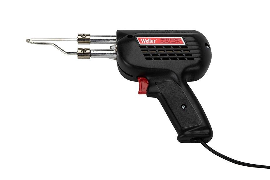

Often wondered what something like a Weller soldering iron would do in a case like this. That way the heat from the gun stays right on the bolt head and transfers down the bolt to the threads. Not all over the primary case. Just a thought. Has anyone tried it?
This guy.......
You’ll have another birthday waiting for one of those to heat a bolt enough to do any good.
LOL........ and I'm running out of birthdays, soooooo.........
Maybe that's why I haven't of too many people trying it!
