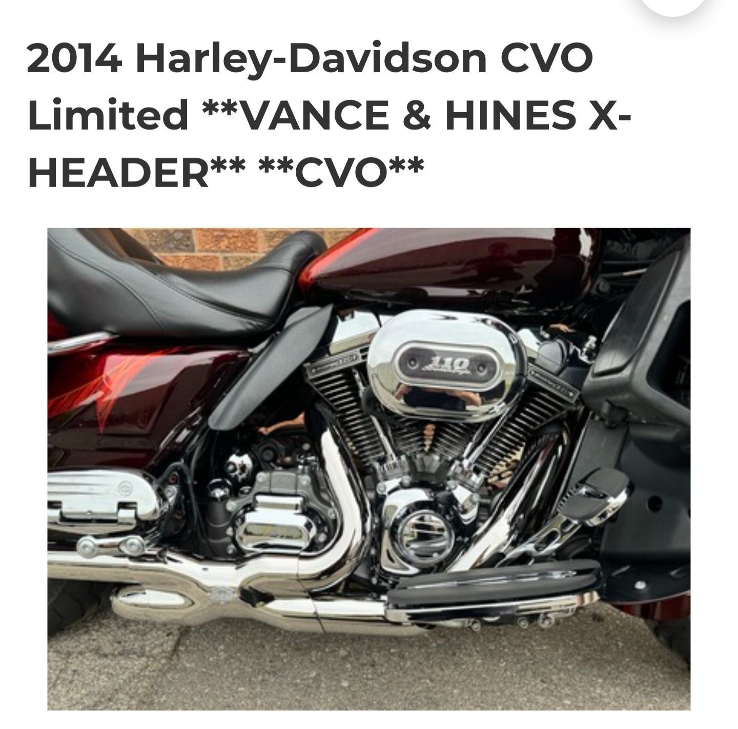

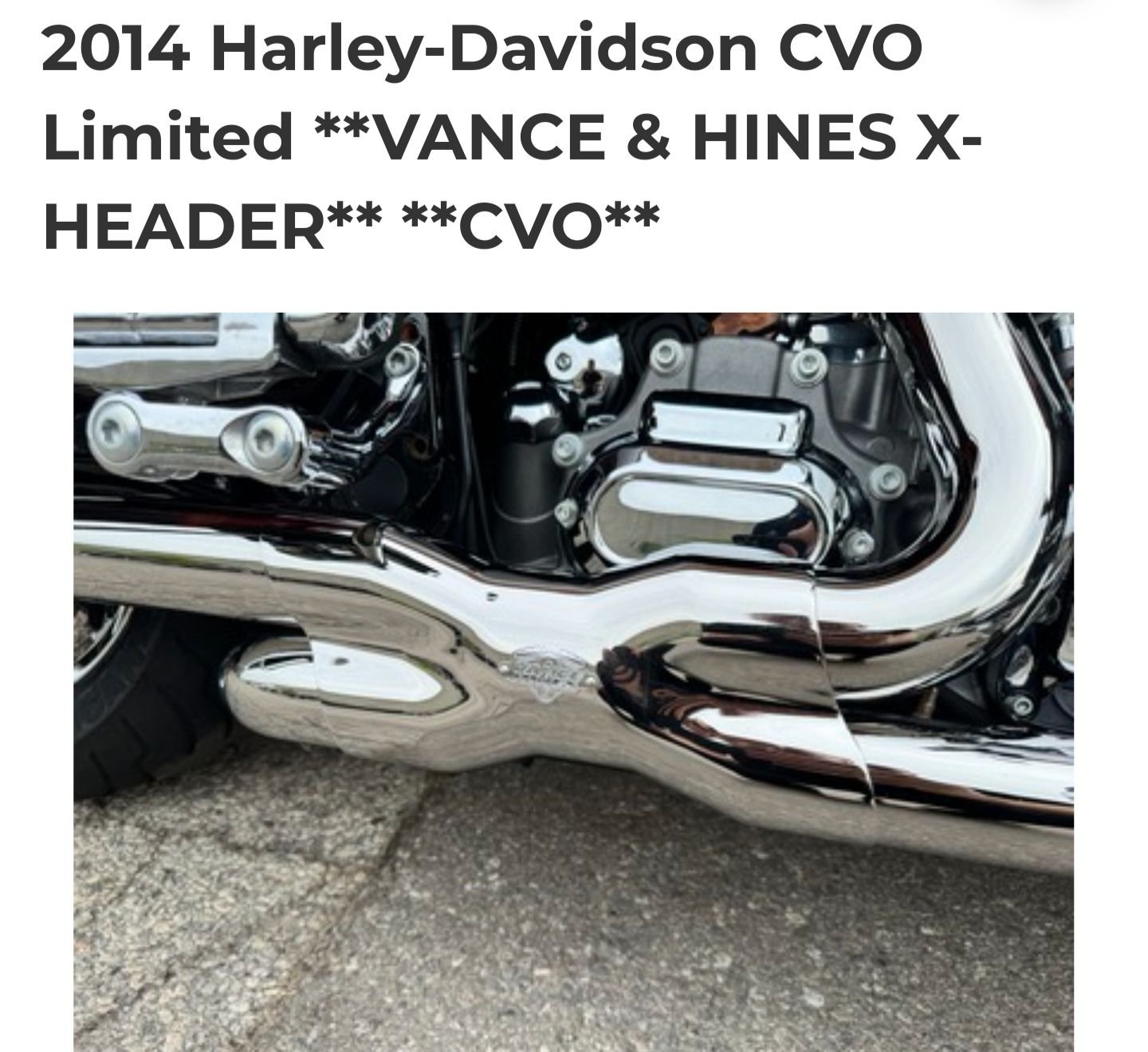

Next question... Is there any advantage to the Vance and Hines " Xheader" not sure if that's the correct term or not. This bike has Vance and Hines pipes. Slip ons I'm guessing?

V&H power duals, I like the pipe but the mufflers are probably louder than I’d want. If its too loud for your liking you can keep the pipe and change just the mufflers. You’re at the edge of the rabbit hole now. It’s a 10 year old bike and you don’t know if it’s had different cams, pistons etc. and has it been tuned for whatever modifications, if so then by whom with what device. If you can track down some history it might come in handy if you wanted to mess with it.

So are these true duals or just slip on mufflers? I don't mind loud because on my 2006 heritage I have Vance and Hines big radius with hardly any baffle in it. I think the baffle consist of a steel ring with the tuning key and not much more. The place I bought the bike from said they don't have any history on the bike. Not sure if the dealer would be able to pull up any history with the VIN number.

It’s an aftermarket V&H power dual 2-1-2 header with their slip ons

Sorry for my ignorance but is this then considered a full exhaust system rather then just slip on aftermarket mufflers? I'm assuming so.
