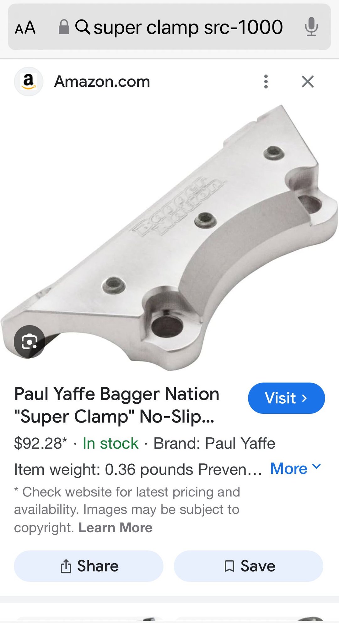

so the bolts are not loosening at all. Harley and myself both think that it's the actual clamp that needs to be replaced. They said when you put aftermarket bars like that, the OEM clamp doesn't always support the leverage. They suggested this clamp and it should fix the issue.

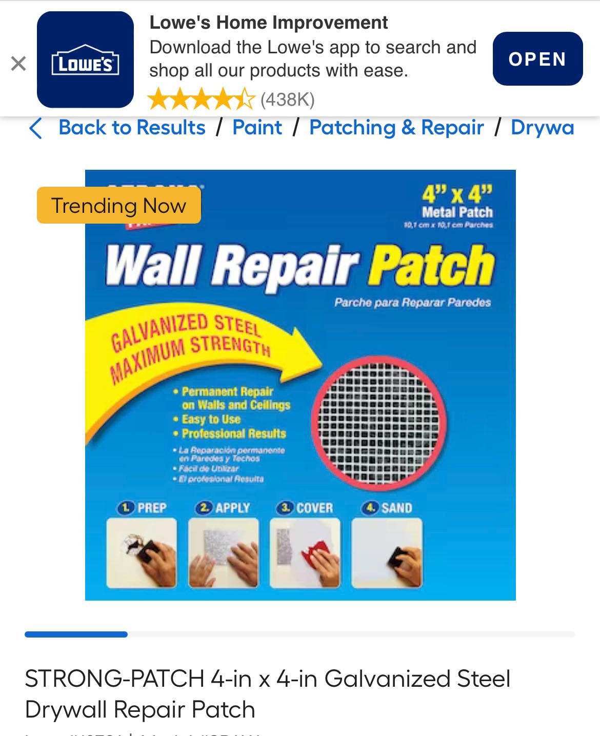

GP097 - I would have used the set screw style clamps, but I have a batwing and you have to pull back the plastic to get at those set screws.
I just changed bars for the 2nd time and did this:
**I had some slippage so I rasp filed the stock clamps. Then shaved off a bit of material off the top clamp. Then for added measure, I popped in some of these sheet rock screw repair material on inside top and bottom of clamp. The bars don't move.**
I also woulda installed the nylon riser bushings. I still would if I were you.

ill add on, i have the yaffe clamp on my bike and it works perfect. you could drill and tap the factory clamp too but the yaffe clamp is seriously beefed up over the factory one.

I bought a knock off for about $30 that looks identical to the one above.
