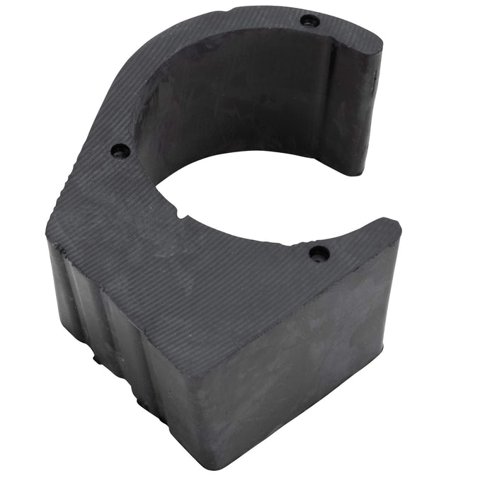

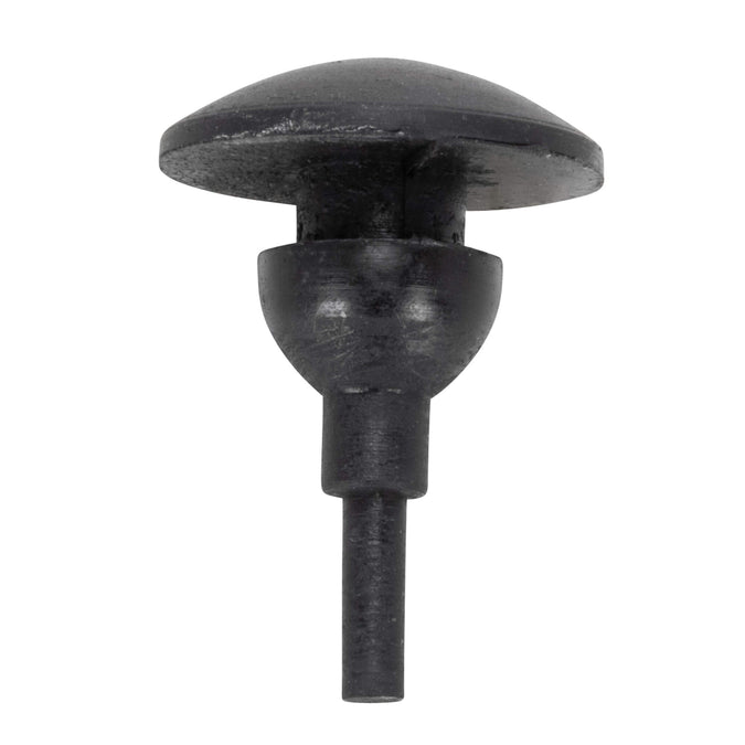

Yep, guessing that rubber bumper was pushed out of index when bike was lifted with lift, and need to have someone hold the bike up, as you put the jiffy stand up and re-index the rubber bumper stop to its needed position, so jiffy stand is against it, and not the frame..
In most cases on the touring frame bikes, the rubber stop is a C type unit that clamps to the frame, so just need to grab and slip it on the frame to slip it back down on frame (that the lift slipped it upwards), to the needed rotation position.
And get into a habit of checking the rubber stop, every time you lower bike down back off the lift, since about anyway you jack the bike up on the bottom of the frame, is going to cause the stop to be rotated upwards.
Or could be this type that mounts on the jiffy stand instead,
As for installing jiffy spring, remove top stop plate and nut of jiffy stand, so you can rotate the jiffy standd past center forward to remove old spring, pull it to clean and re-grease its shaft and bracket part, install it with spring hooks greased as well with jiffy stand forward past center, then rotate back past center to reinstall the top stop plate and nut again.
