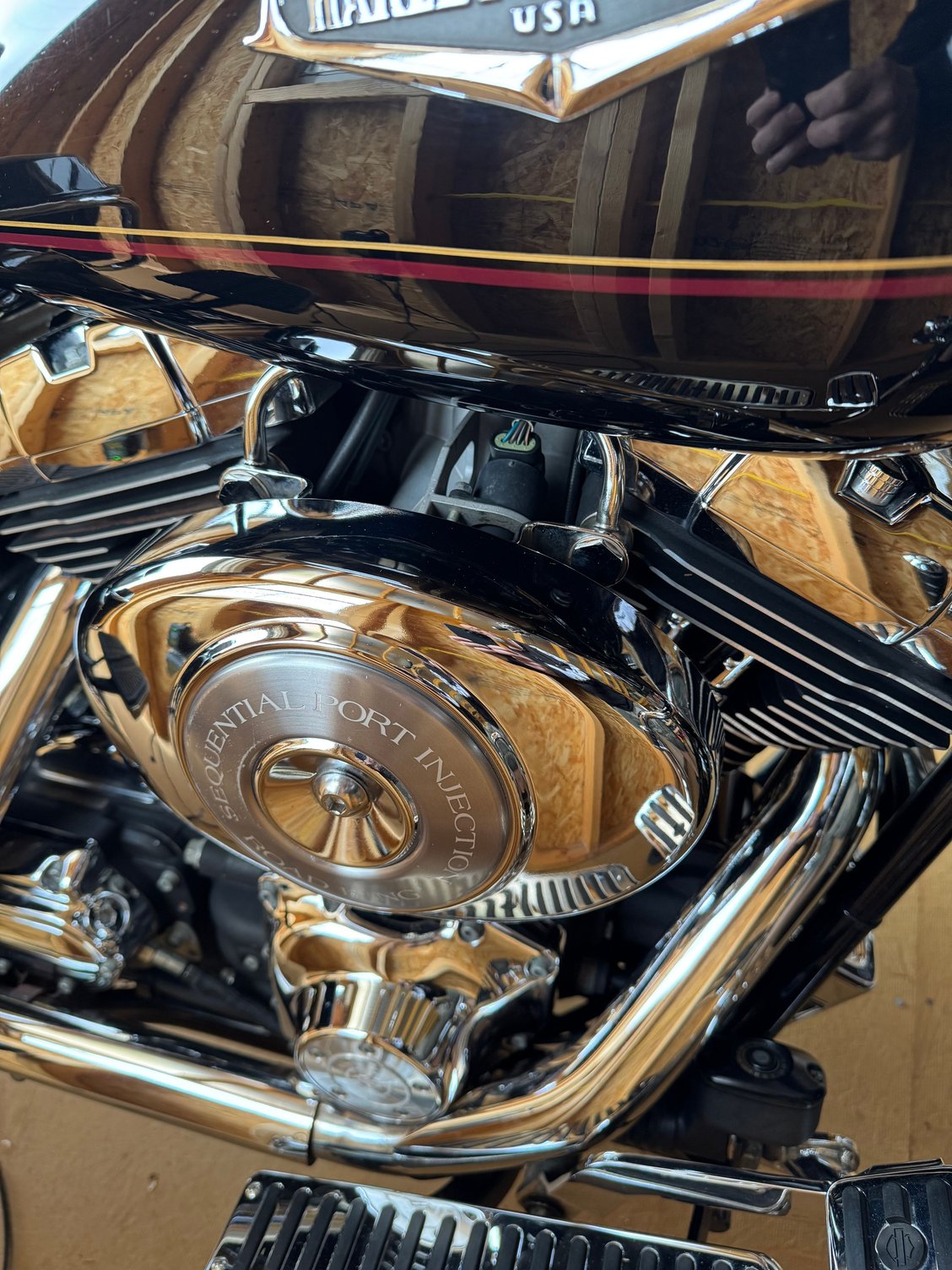

Hey I have a 2001 road king classic, does anybody have a good source on a good used stock air cleaner assembly? I have the outer cover but not the rest of the assembly that bolts to the motor! Right now the bike has a K&N style aftermarket element in it but it does have the Harley shield stamped on it, this is the M M efi so I need a box that fits that. I’ll include a picture of what I have now. Thanks for any input!

The gaskets, induction #29368-99, (#8 in pic) & filter element #29463-99, (#11 in pic), breather screws #29465-99 (#12 in pic), breather tubes #29476-99 (#14 in pic), back plate o-rings #11292 (#2 in pic), and the filter mounting screws #946 (#1 in pic) all still show as available at a dealer.....

Lost here, since you do have the better high flow air Screaming Eagle factory upgrade air cleaner system on the bike to begin with, and the HD/K&N air filter that you can clean and reuse as well.
As for mods to the screaming eagle system , maybe a catch can so the breathers are not puking oil in the air filter void section to be draw into the cylinders, which the Basic factory air cleaner assembly is going to do as well, and no real fix with that system to add in a catch can, or just pipe such down and out of the bike..
And trust me, anyone with a RK that does have the basic air system on the MM bikes, will trade you straight across for your screaming eagle high flow air system.
Just remember that they need the back support plate with the swap,since the basic air filter system does not use it. So shorter breather bolts, back suport plate that the breather bolt are holding on, and everything outward of the MM intake manifold, and you will use the same from the basic lower flowing air system, to bolt that onto your bike.
