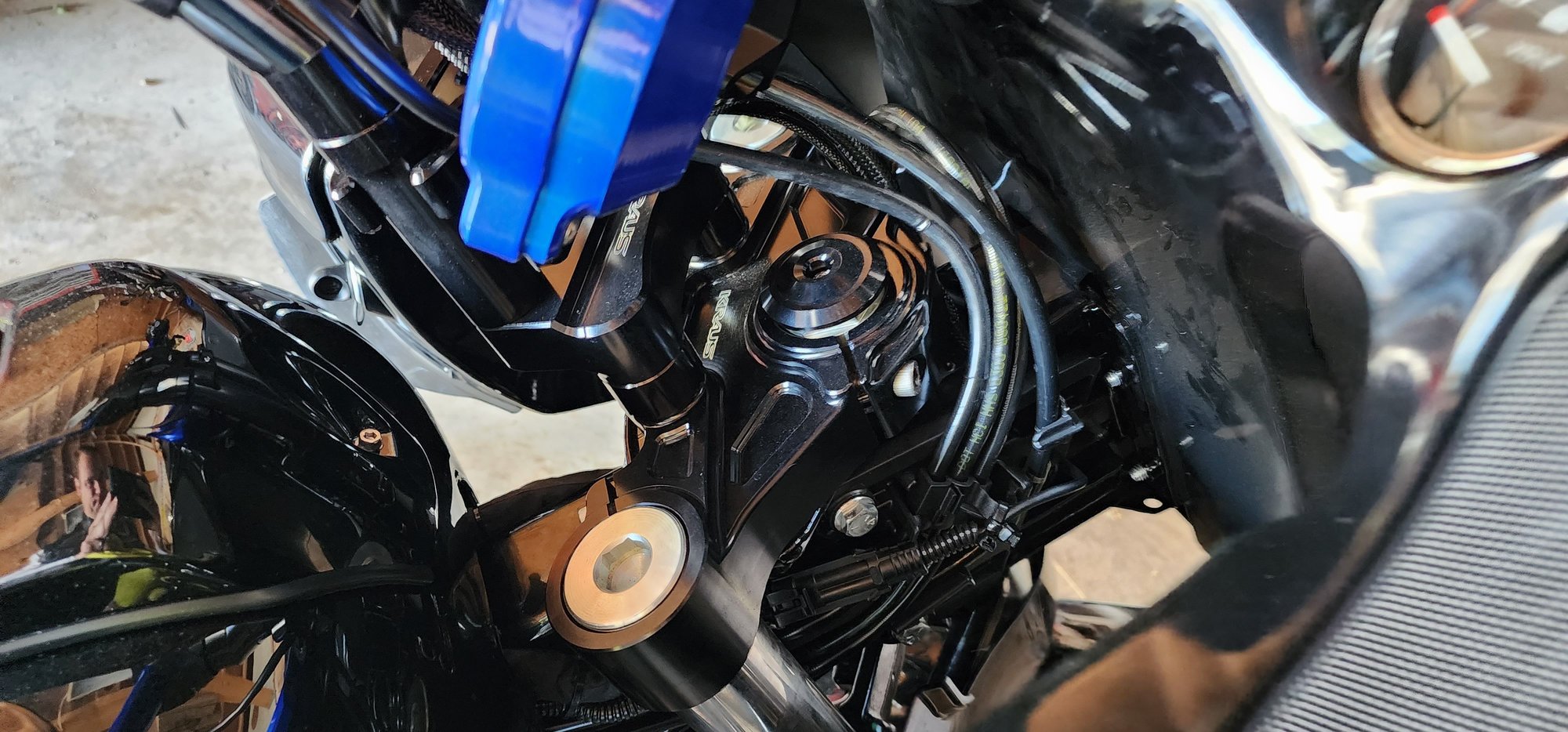

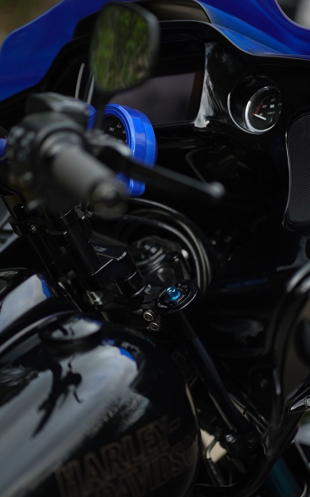

I went with a set up from thrashin. Way better than the stock wheel barrow bars. Not everyone is a fan of T-Bar styling, but it made the bike feel much more nimble and raising the height helped the perceived weight of the bike by gaining some leverage. YMMV
