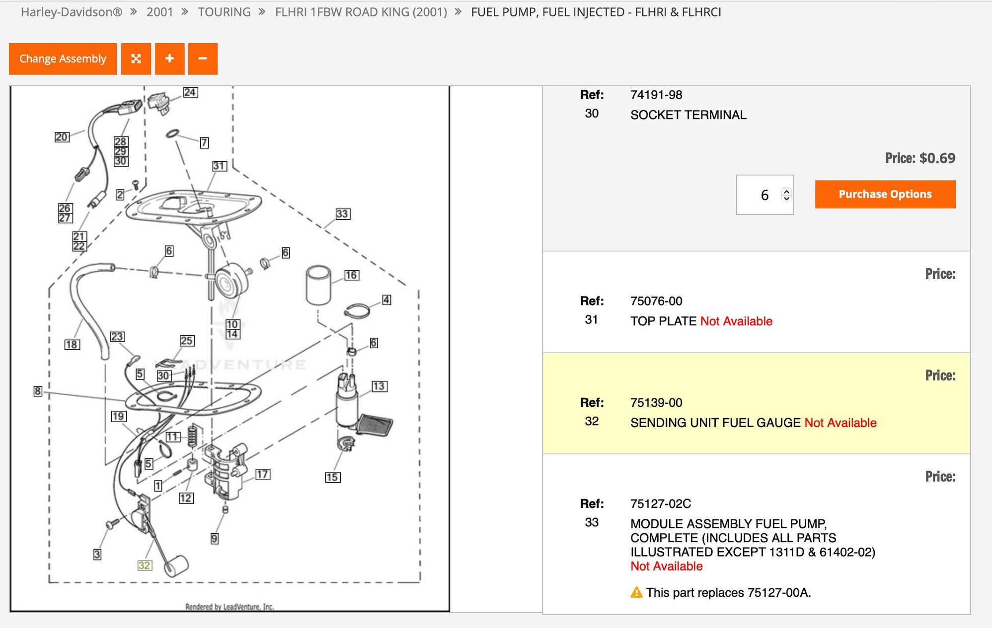

Currently working on a 2005 road king (fuel injected) I am in need of a whole fuel sending unit and the guts. Ronnie's doesn't have one, neither does the local HD dealer. The oem part # 75127-02c. I've found one that looks identical 75127-00a for a 2000-2001. Can someone explain the difference in the 2. I though road king used the same style tanks till 09.

I can't answer your question specifically.... However, according to the Harley-Davidson OEM Service Parts finder, the #75127-02C assembly was the replacement part for the #75127-00A when it first went obsolete.
Of course, now the #75127-02C is "Not available". I would think the fact that it was listed as a replacement for the "-00A" for awhile suggests they are either interchangeable, or require few mods to be interchangeable.
Here is the 2005 tank guts showing assembly #75127-02C:
Here is the 2001 tank guts showing the #75127-02C as the replacement for #75127-00A:
I hope this information helps..
Good luck with your repair.

Thanks for the help. I guess harley thinks noone has older bikes to work on., they don't even have fuel tanks anymore. Took about 6 months to find one not beat to hell.
