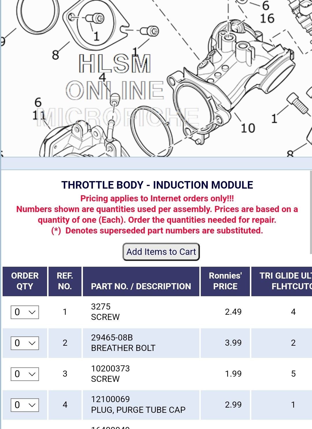

The umbrella valves (poppet valve) is a one way out. So when motor is running, there open.
And after it sits a while, the small amount of vapor that is oil collects on walls of the passages ways will run down and spit into air box. All normal if you have vents in air box.
If you can hear a hissing sound over that exhaust, that's amazing. If you really do, make sure you don't have any any lines loose off throttle body if you have a charcoal canister. Could check for intake leaks. (See YouTube)
Again, I don't hear anything but I also don't trust dealership especially if there not getting paid for their work.
See 4. Hose or cap there.
