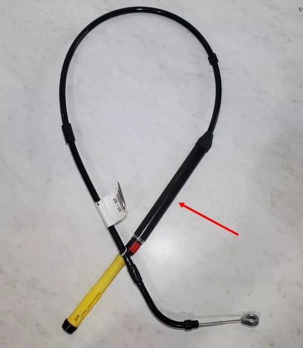

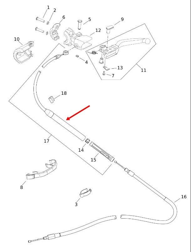

Originally Posted by 1527
So I had a full system installed by Harley some time ago. I recently purchased another exhaust because the shorty 2 into 1 was too loud for long trips. Well to my surprise I noticed the front heat shield burning the part next to it. Is this normal? ( I know its not "normal" but is it a big deal) Or should I replace this part?

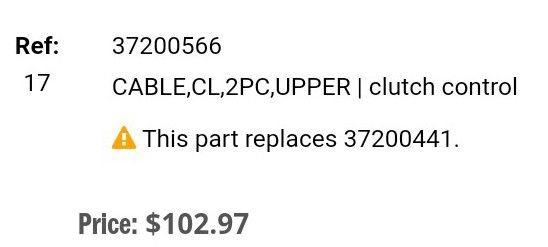

I don't believe those are exposed wires. I believe that is the black (plastic?) sleeve that covers the yellow plastic clutch cable adjuster. Your clutch cable appears to be routed correctly (clipped to the right downtube). I suspect it melted due to excessive idling without airflow. Under normal operating conditions, it shouldn't melt.
Unfortunately, the sleeve (red arrows) isn't available separately.
A proper repair would require replacing the upper clutch cable assembly (#17).
