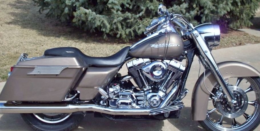

I've had several Road Kings & they were all great bikes. My last carbed one was this '04 FLHRS. Ran beautifully & had soul. Miss that bike.

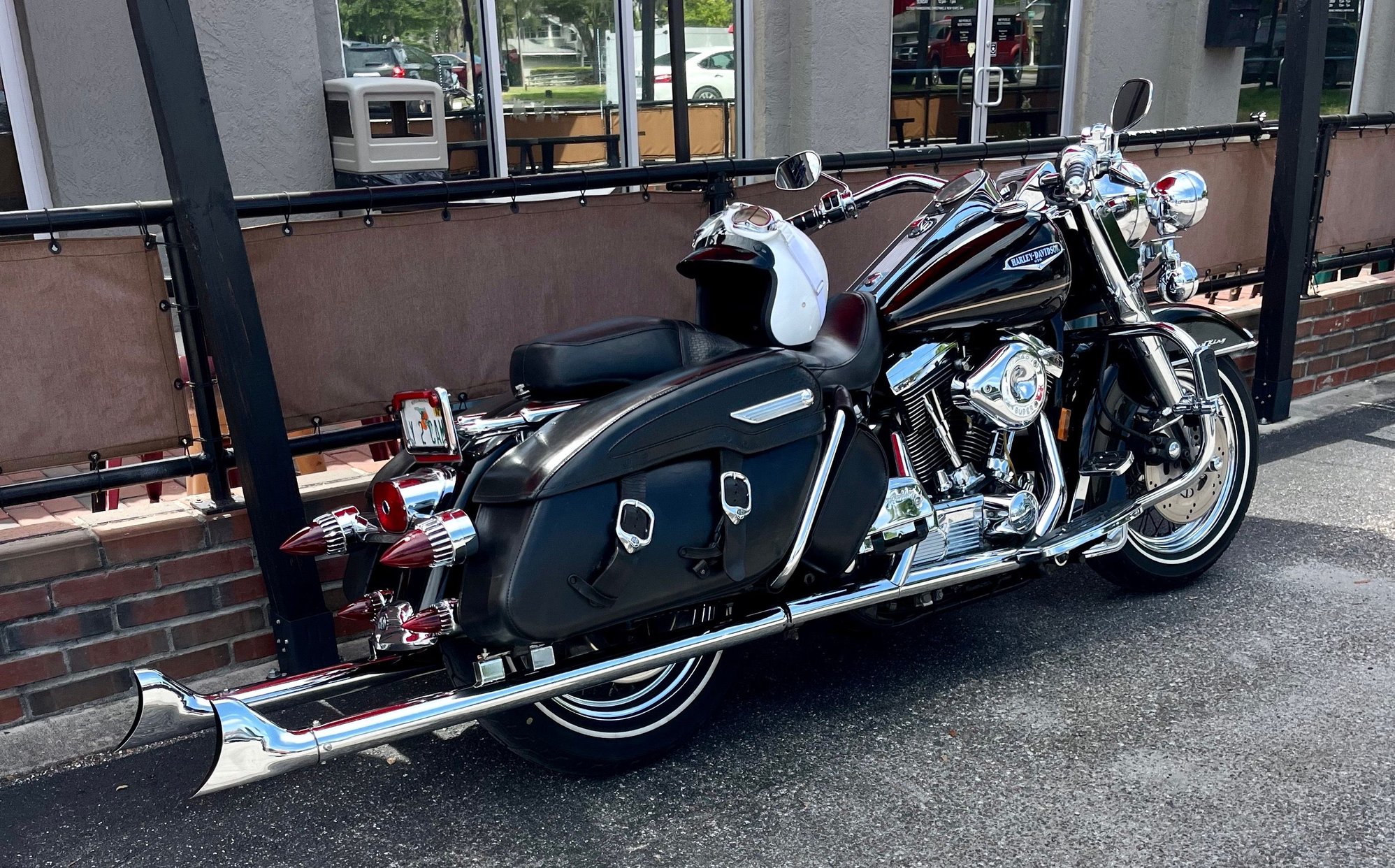

My 98
I only have like $6k in the entire bike now, I bought it with the stock 80” now it’s a 113” motor I bought on market place and rebuilt, Primo Revera Pro clutch w/variable pressure plate. Rebuilt 7 weight to 10 weight rear shocks, progressive heavy duty new seals front. New rear tire. Converted to 4 piston late model brakes, 2000i ignition, new exhaust and new tail lights with all new fluids and repacked barrings all for that money including the initial purchase. I’ve only had it a year and have put 20k miles on it.
The ever so controversial BULL. I was on the fence, but love it now. It’s polorizing and I often find groups of people standing around it debating it. It’s awesome.
