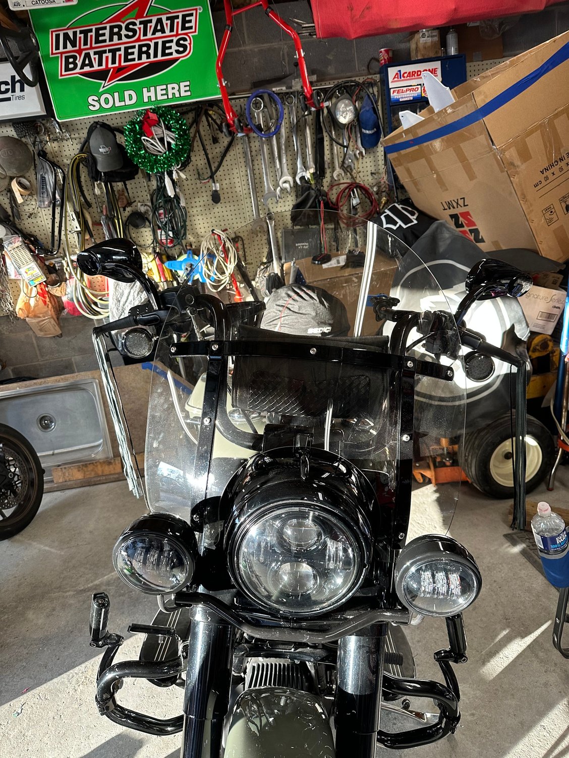

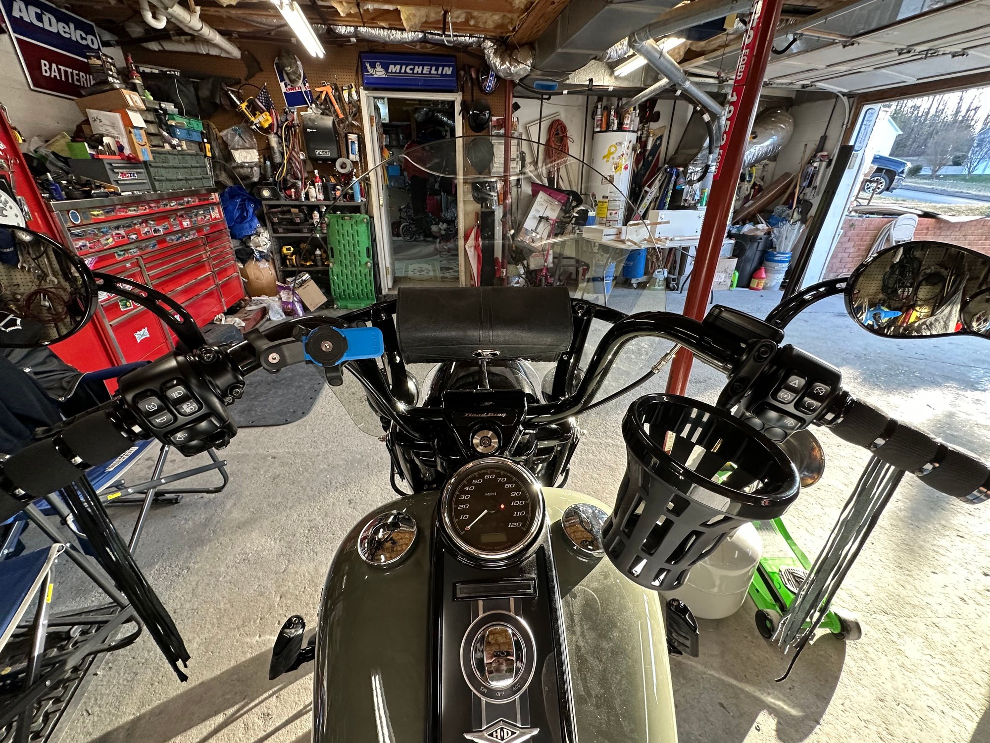

Just an FYI if anybody is looking for an inexpensive handlebar for a Road King Special. Shorter rider here and the OEM 36” wide minimal pullback just wouldn’t work for me. Installed a set of 2023ish Road Glide bars. They measure 11” rise and between 7-8” pull back. Only had to cut 2 little “nubs” off so my controls work. Also had to buy a Fatbaggers 4” clutch cable extension. Total cost is less than 175. Bars are all over eBay.
