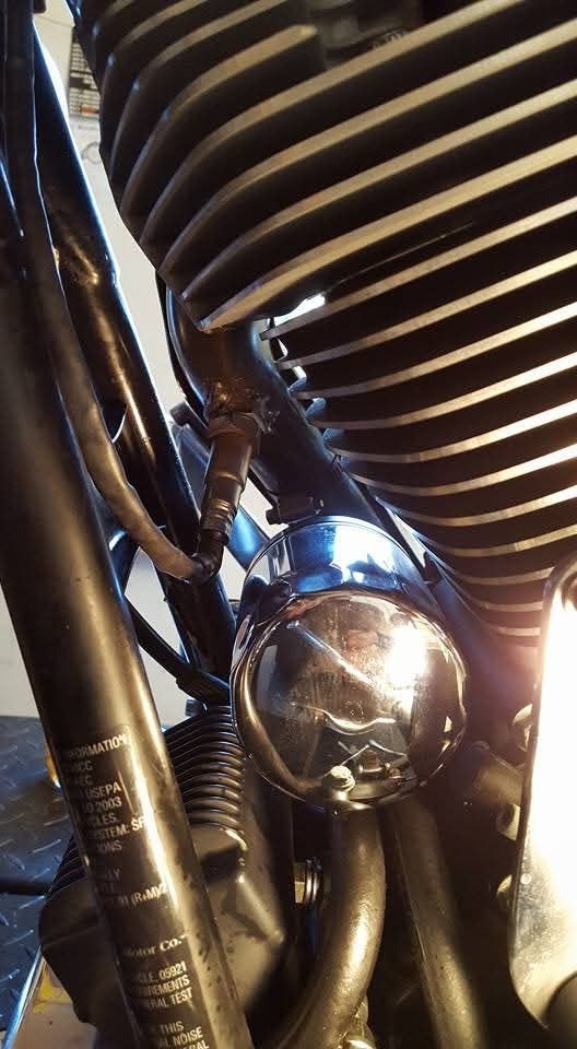

As stated above my '03 did not have O2 Sensors. (My'13 originally had smaller narrow band open loop sensors) So I drilled my head pipes and welded in 18mm bungs 1st for the PCV Autotune 18mm Wide Band Closed Loop O2 sensors and later used for the Thundermax O2 Wide Band O2 Sensors.

1st thing is to purchase the 18mm O2 Bungs. Then you purchase a hole saw, saw to drill adapter and I purchased an extension for the adapter.
Next you think long about how to get the O2's close to the head port while having enough room to screw the O2 sensor in or out and have an understanding of the O2 cable and how you would route it back to the Tuner Module.
Once you are sure you have the location, center punch the head pipes, and drill / Saw out the hole. Now you need to weld the bungs to the head pipes. In my case, I could only tack the bungs in location then removed the head pipes and welded around the bungs. After that its just a little more work to put it back together and install the Wide Band Sensors needed for AutoTune. I did mine 1 winter morning over a few cups of coffee.

Also ensure where the bugs and O2's are located will still allow you to loosen and tighten the 2 exhaust to head bolts. This is a Pic of my O2 drill rig and where I placed them on my '03
