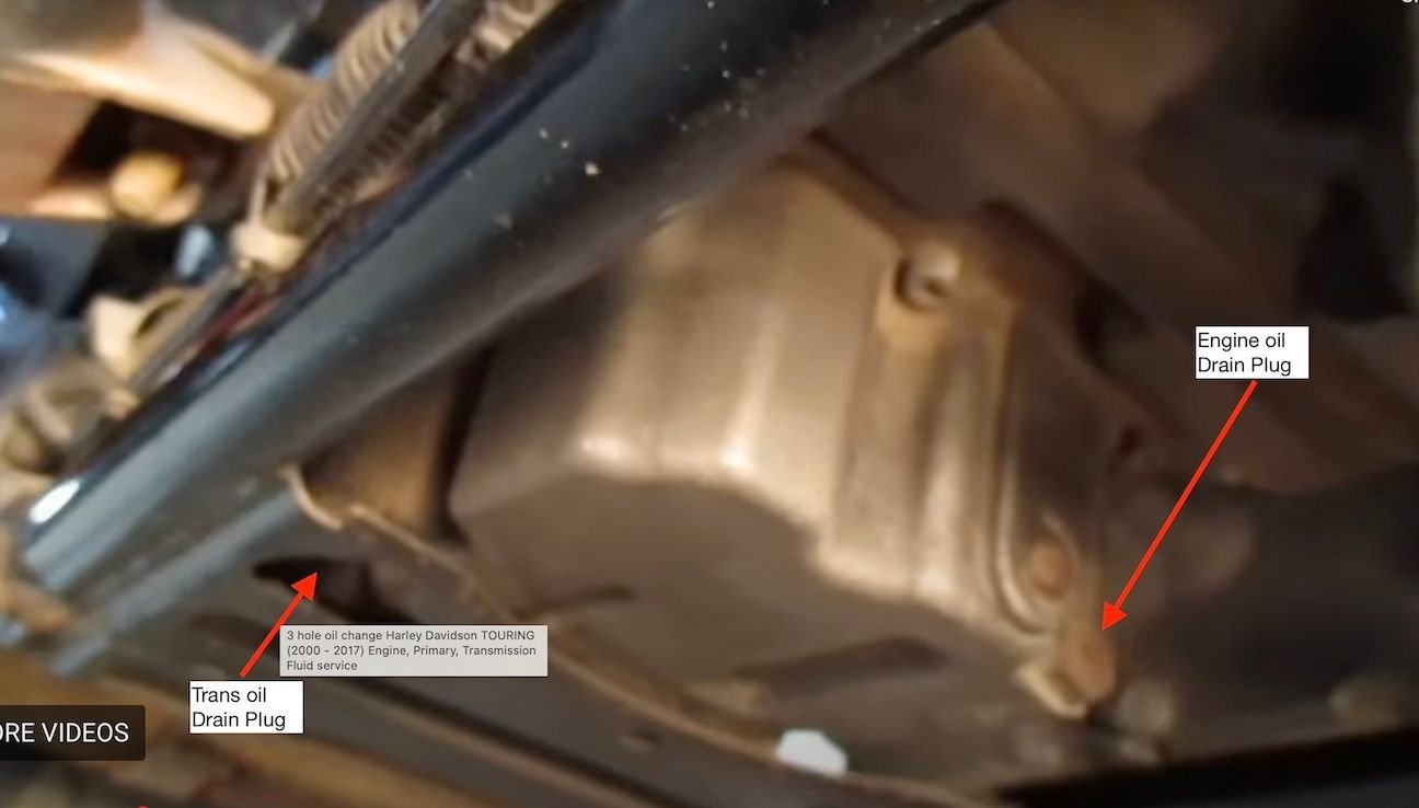

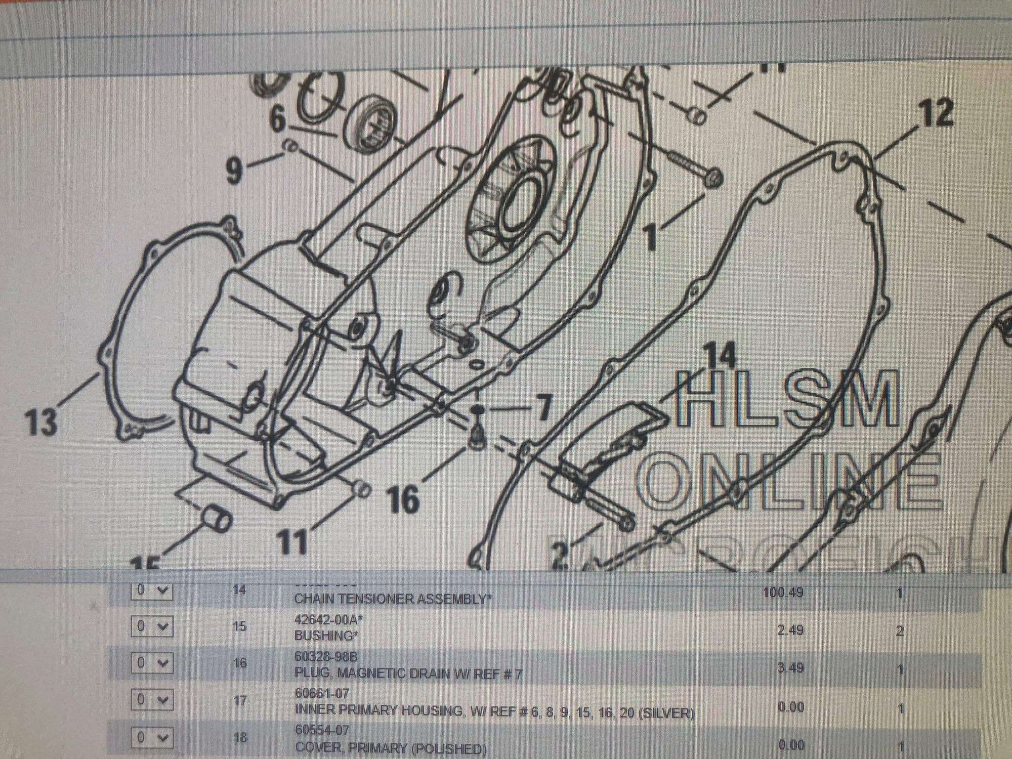

The primary is the same as your softail. The drain plug is on the inner primary cover at the rear.
Between this illustration and the blurry pic (I captured it from a video online), you should be able to find your trans oil drain and your engine oil drain.

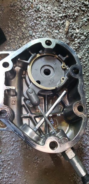

Here`s the primary as mentioned above.
