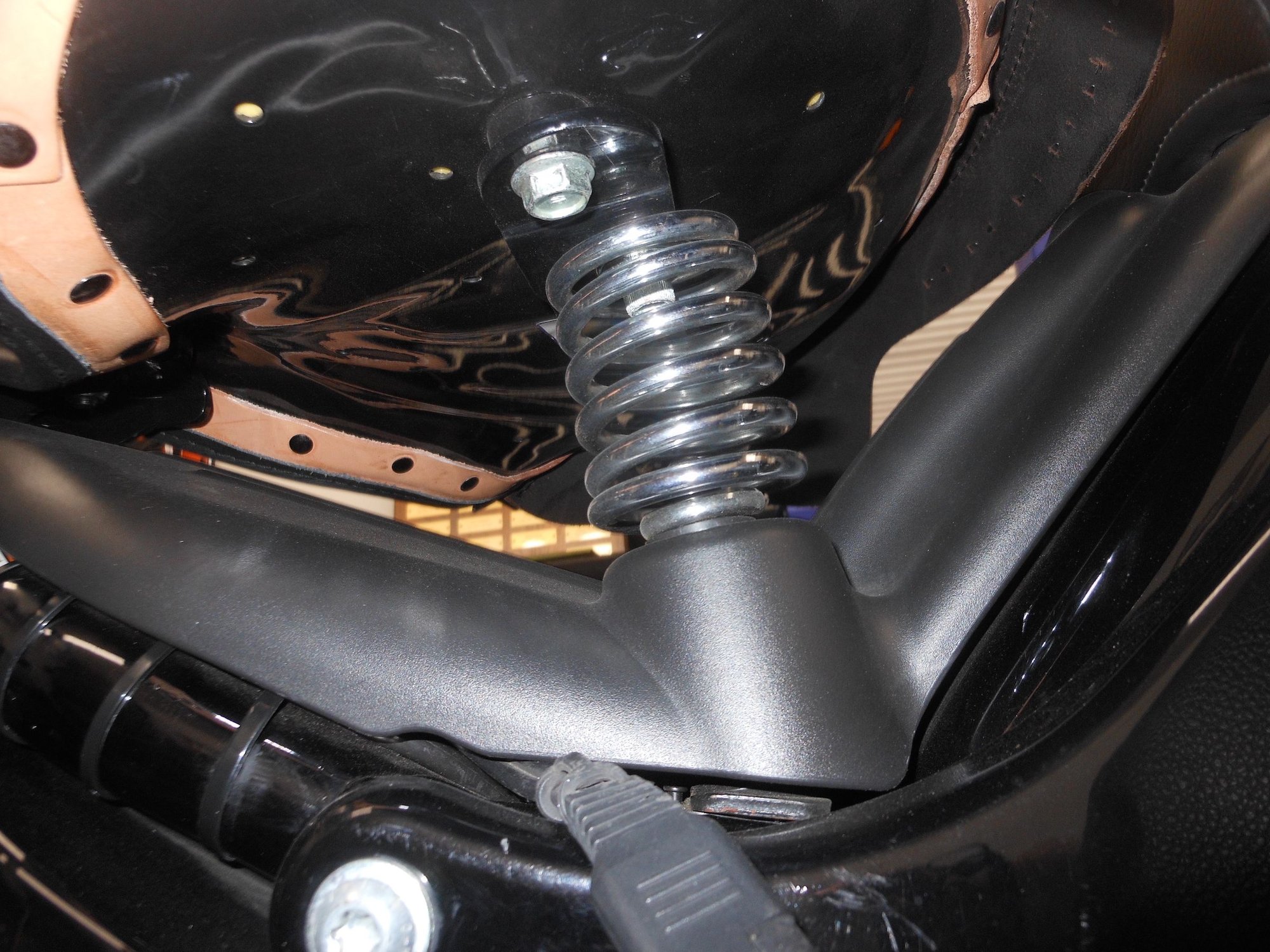

I put the V-Twin Corbin-Gentry seat, with the skirt, on my CrossBones... but I used the springs. That seat is pretty firm. I would think it would be a pretty hard feel without the Springs... Additionally, you would have to fabricate some type of mount system. It is set up with the slot on the front of the seat for the hinge mount, and just two holes in the rear of the seat pan for the spring base to mount to the seat. You'd have to be creative.

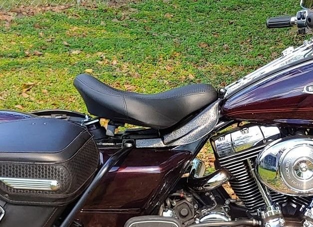

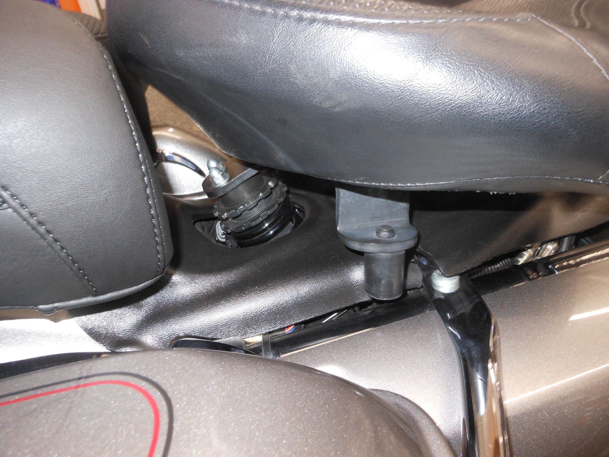

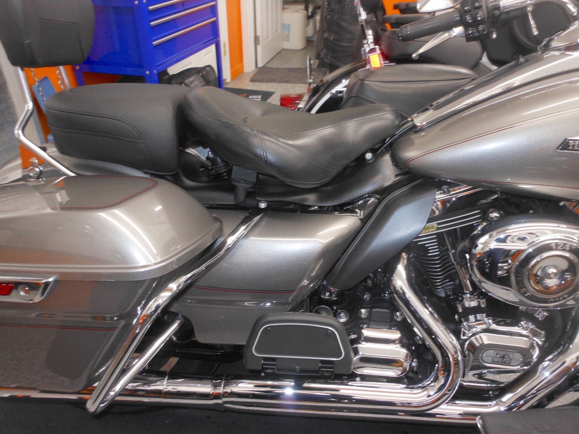

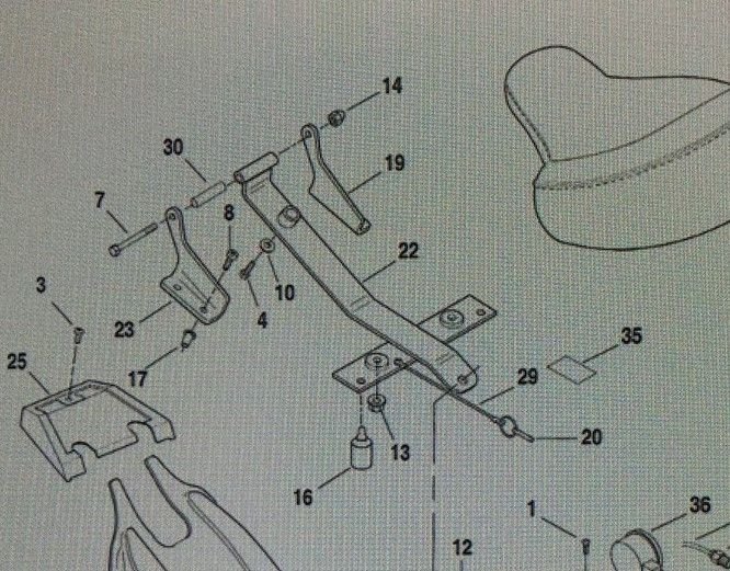

If I might add this:
I'm not sure how far back the "early" style police setup is the same, but on my 2006 Road King Classic, the T-bar for mounting the seat has the front bolt in front of the seat and raised slightly. I believe this also helps lower the seat more toward the frame. If you look at the way the later seats (like what @hattitude has on his 2016 bagger) mount to the T-bar, you'll see they have the bolt for the front mount under the seat. I'm not sure if there IS much of a difference in height, or if the one I used on my RKC would be the same for your '99. If it is, things may be working better for your situation simply by design.

Early-style police seat exploded view
Here's a link to a pdf that shows the later-style police seat mount and the earlier version for comparison.
https://www.hdforums.com/forum/attac...612d1605646979

It appears that using any of the readily available parts puts the nose of the seat so high that dropping the rear closer to the frame would result in way too much slope
Early-style police seat mount on my 2006 RKC
I agree, I don't think there will be a noticeable height difference at the front of the seat between your style police seat and the police seat for my 2016 model, due to the fact that my front seat bolt is a good 4 inches behind and below the nose of the seat. Your front seat bolt is in front of the nose of the seat. IMHO, that requires the higher bolt position, which I think gives it a very similar height as mine, with the bolt lower and back.
