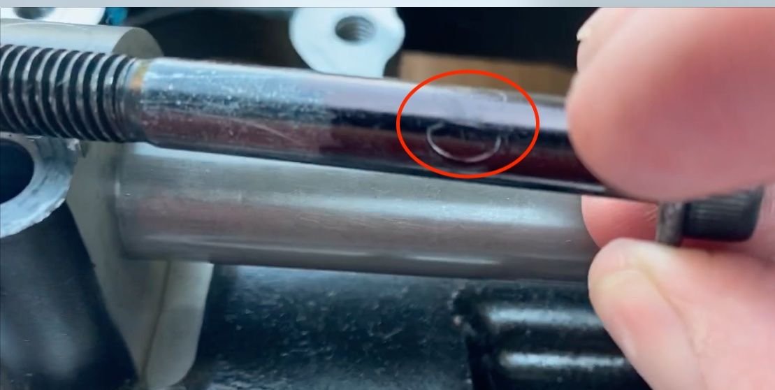

The Rockouts were designed to solve a very specific problem... The rocker arm shafts have a relief in one end, where two of the rocker arm support bolts will hold them it in place. If those shafts are loose in the rocker arm support, they will turn back & forth with the rocker arms and tap against the top portion of the rocker arm support plate bolts (the two on the pushrod side of the engine). There will be witness marks on the shoulders of those bolts, if this issue exists in your engine.
If you inspected the rocker arm support bolts, and found no witness marks on them, then the Rockouts will not stop your noise.
Of the six Twin Cams I've owned, only one had those witness marks and the Rockouts stopped the noise. I added them to a couple other Twin Cams with some noise, but no witness marks... As I suspected, they did nothing to mitigate the noise on those engines. They don't hurt anything, so I just left them in.
The marks may be subtle, or they can be quite obvious. I suspect the total mileage and/or looseness of the shafts, will affect how obvious the marks are, and how loud the noise is.
This is what the subtle witness marks will look like on the affected bolts.
