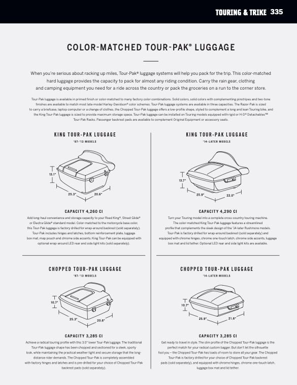

For those interested, here's the dimensions of the old vs new TP. Main difference is the new has a more angled front for better passenger comfort. The difference is not much for the king TP and none for the chopped, per H-D dimensions. This is from the 2020 H-D Parts catalog.
