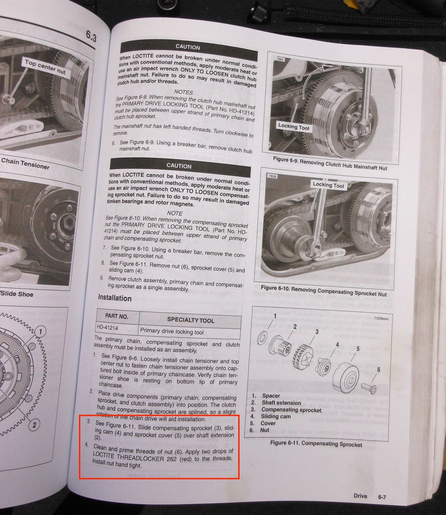

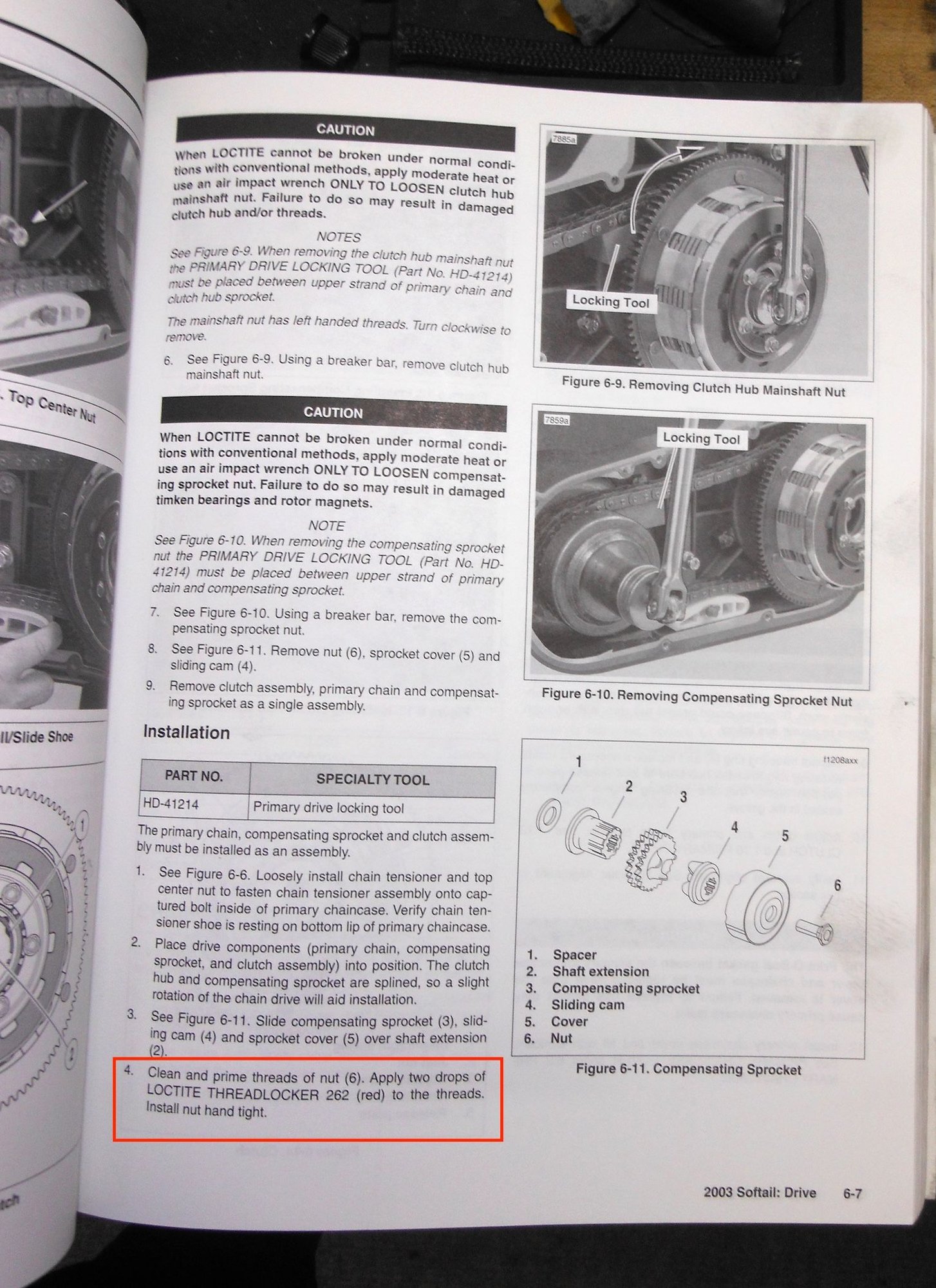

Old Jun 29, 2025 | 08:40 AM
hattitude's Avatar
hattitude
Posts: 14,253
Likes: 11,374
From: San Diego, CA
FWIW....
Early TWIN CAM Factory Service manuals say to clean the comp bolt threads and add red locktite for assembly.
Later manuals say to replace the bolt, it's one-time use.
Some speculate that the MoCo changed to one-time use just to ensure a proper threadlocker is used on the bolt.
From 2001 Softail Factory Service manual:
From 2003 Softail Factory Service Manual;
