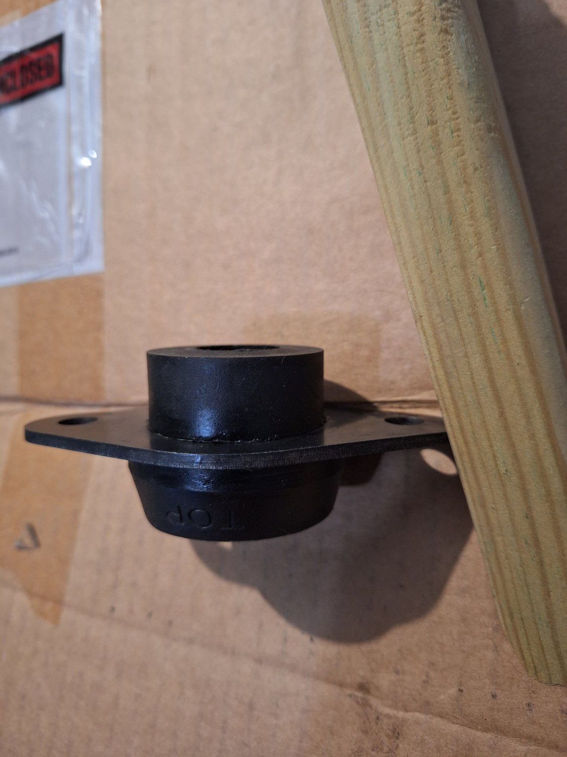

It looks like it might be two different types of failure, but I'm not certain of that.
It looks like there's some solvent or oil damage in a few spots. But I'm far from sure of that.
It also looks like rather classic tearing damage, coming from over moving an overly hard plastic. The Volvo car world is full of this from people buying into the hype of urethane motor mounts and such. Yes, they're stiffer, they also rip apart faster because of that increased stiffness. Same the urethane suspension mounts. They just can't take the amount of motion involved in the application.

The poly urethane has just turned to mush. It is not ripped it kinda melted. It is extremely sticky. I had to use acetone to get it off my hands and to clean the area it was sitting. I do all of my maintenance and it does not get oil on the mount. I agree it looks like it was soaked in some type of solvent. It was not. I clean bottom half of bike with s100 and water from hose. I do not spray s100 there but I would be certain it runs down on it when I clean bottom of bike.

S100 shouldn't damage a polyurethane motor mount, and if it did, you would see it attack the outer surfaces first, which this broken up mount doesn't seem to show.
So I rather suspect a poor casting by the manufacturer. A bad mix? Bad ingredients? Low curing temperature? Etc. Any could do this, and more. Leaving you a part that isn't solidified or cured, but could still be skinned on the surface.
If they want to call it a "normal failure" for a urethane part, ok. Maybe it is normal to them. Personally, I wouldn't buy another because that isn't a normal or acceptable failure to me.

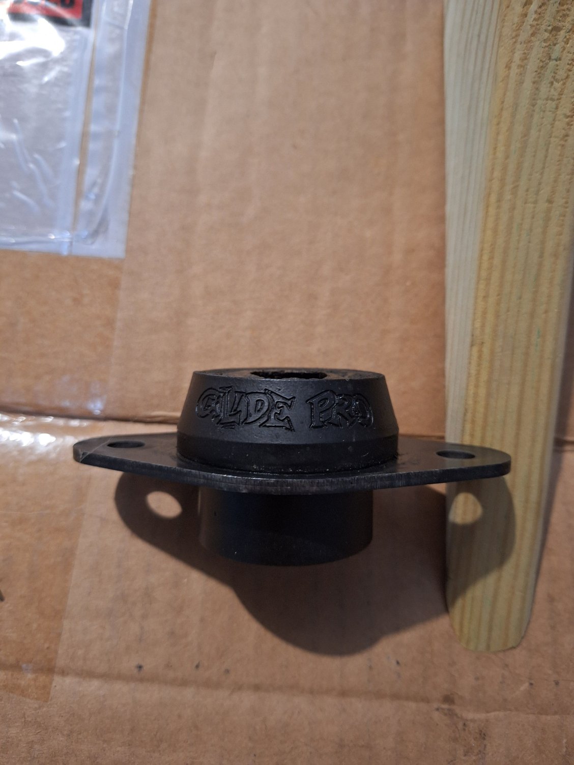

I've bought cast polyurethane from McMaster that has done the same thing.. The softer stuff seems to be more susceptible to decay like that than the hard stuff. I've had stuffing sitting in a plastic crate go bad.

Sounds like they don't heat cure the poly parts. Into an oven at 120 degrees for 4 hours, then let cool to room temp.

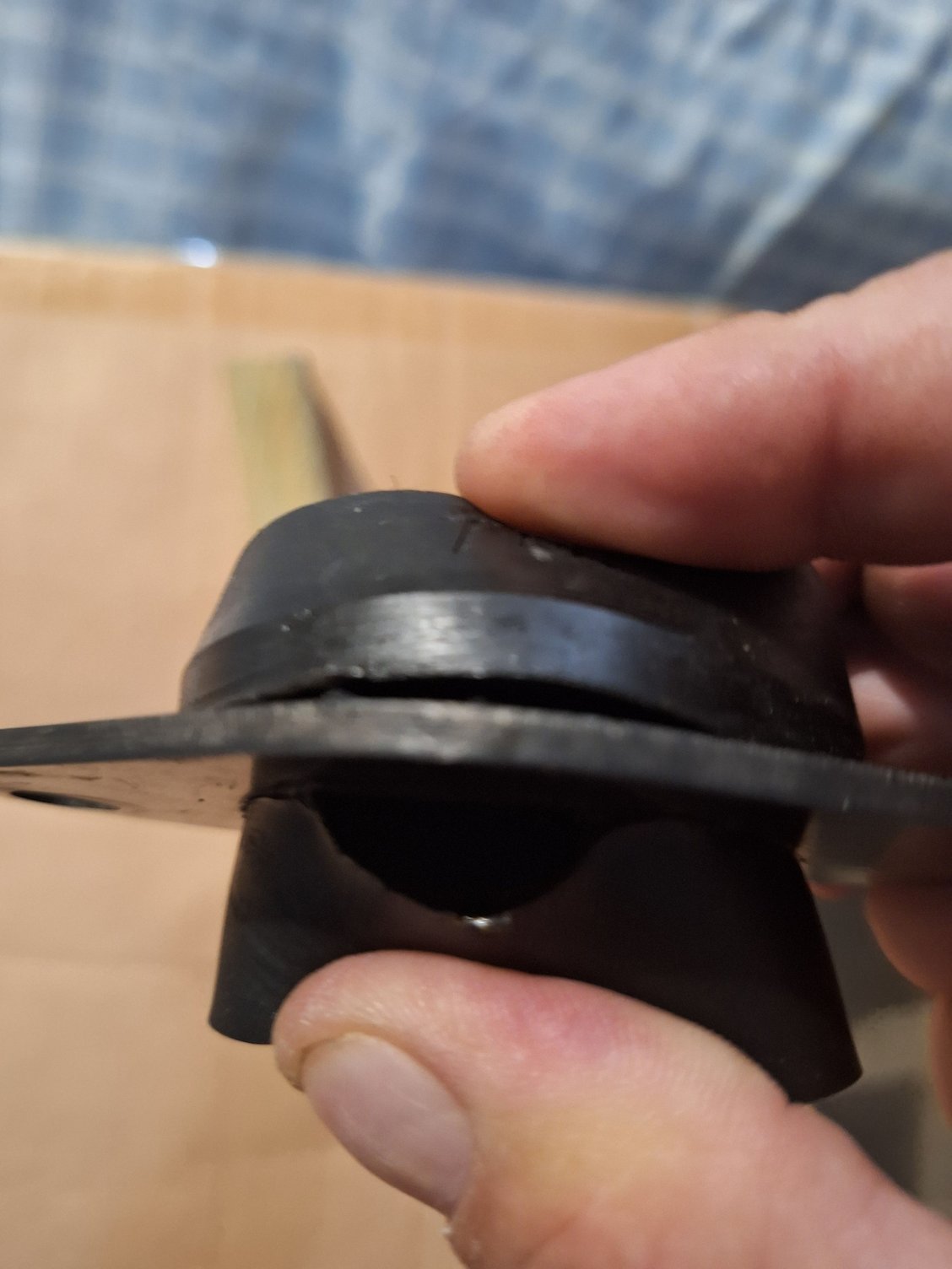

They look pretty normal sitting in the bike until
You remove them, This was my 2nd one that went bad. Never had any oil on it from oil changes because i run a remote filter, I stopped buying them,
