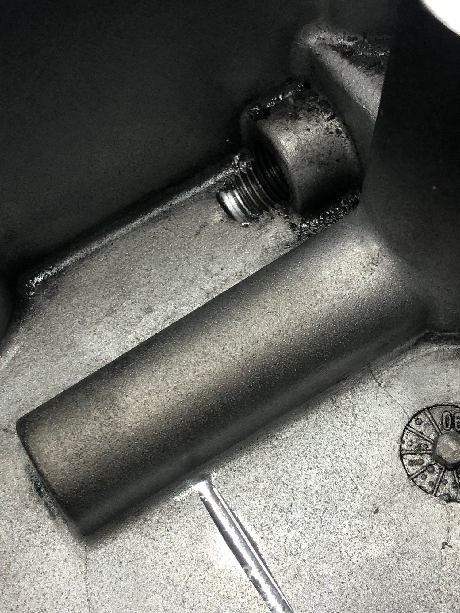

Pictures would help greatly. A very thin wire does not make me think of helicoil or a knockoff, it makes me suspect a home-made bodge with a piece of wire.
You say you have the oil tank out, would I be correct in thinking you actually mean you simply have the pan off?

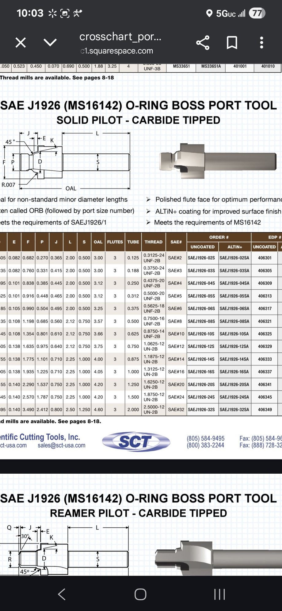

That 9/16 rework was for retooling for a MS 9/16 fitting.
I have that cutter in a set of the 4 common sizes 7/16 thru 3/4

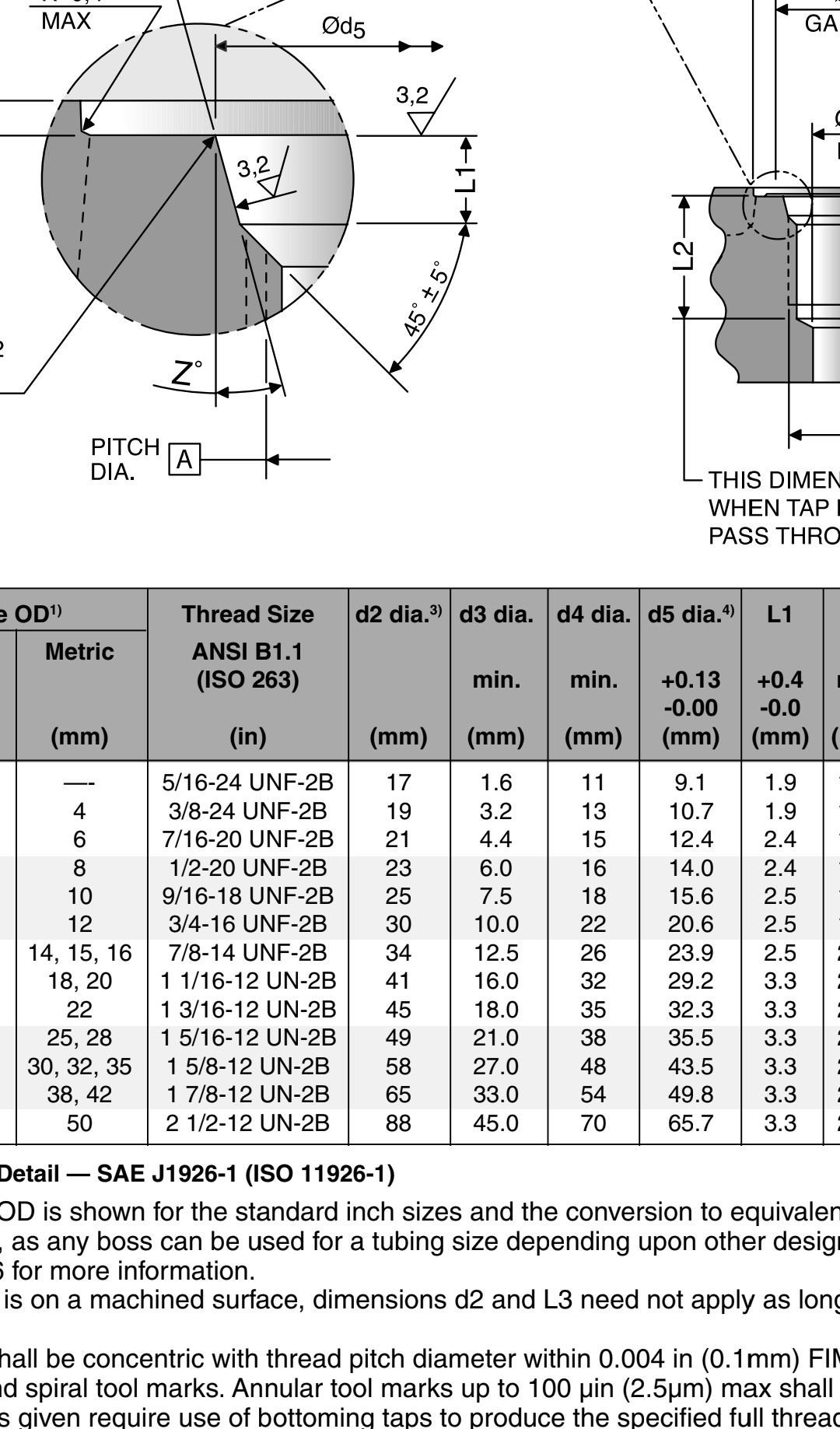

I researched what you are saying.
The tap drill for 9/16-18 is 1/2", so your good there.
It shows an o-ring with that plug. Appears to imply you will have enough of the bevel from the 1/2-20 contour cutter for the o-ring with the original plug. However, if you check the spec, that original bevel is d5=0.551.
The 9/16-18 tap will cut it out. Your going to need a face gasket. I do recall I think they show a tool available to recut bevel for their plug.
Could be wrong and it is part of that timesert kit. That's why I mentioned needing to rework it to 9/16-18. Running that in there before tap would bevel it correctly. (Not going to be able to do that under a bike.)
Should work. Worth a try. Sure is the cheapest method and my opinion your method is the best.
