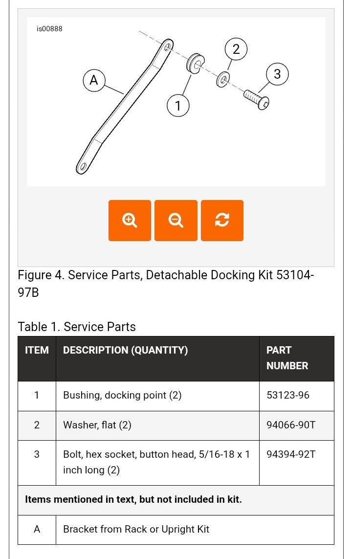

I have a 2001 Road King Classic with the detachable tour pak but the front bushings for the removable mounting are worn out. I have searched for a part number and/or replacements with no luck.
Anyone have info on this?

not sure you can just buy the bushing. Here is a new kit

You were able to just replace the bushing.
It has been a few years though. Check with your local stealership.

this looks like the part. Thank you
The docking hardware on the 2001 Road King is not like the newer style, but this looks like the older style that I have
