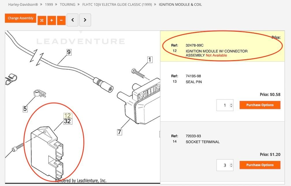

If I may so bold as to offer a couple corrections, for clarity when you give info for us to decipher....
Your carbed bike doesn't have an ECM (electronic control module), those are for EFI bikes.. Your bike has what Harley calls an "ignition module".
Probably a typo, but your ignition module part number is actually #32478-99. The most recent version of that IM is #32478-99C.
They are no longer avaialbe from Harley. If you had an issue, you would need to get a used one or go to aftermarket like a Daytona Twin Tec, Twin Cam Ignition Module TC88.

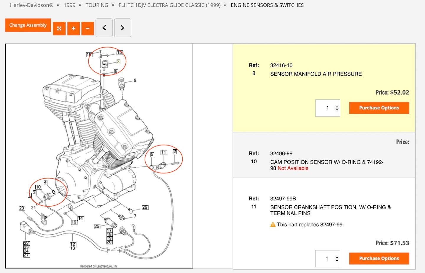

You are correct, you don't have a heat sensor, but you do have a MAP sensor that could need cleaning/testing. As well as a crank position sensor, but I believe you said you already replaced it. You need to look at your cam position sensor. See if it looks like it's oozing brown liquid. That is a sign it's toast.
Here are your sensors and their locations:
Since it originally sounded like the issue was fuel flow, I would have recommended a thorough cleaning and rebuild of the carb. Looks like you did that.
