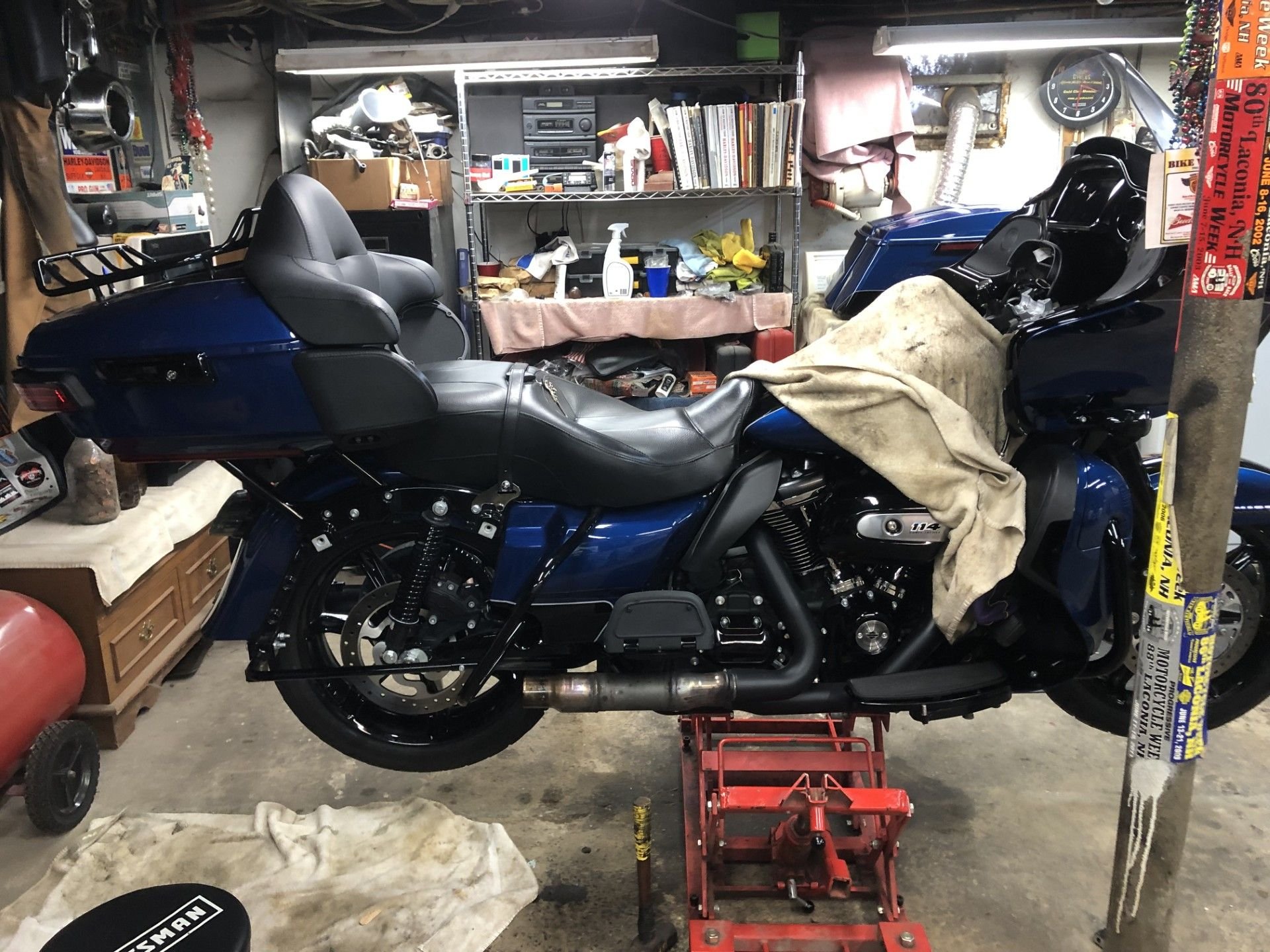

I gutted the cat from my new to me 2022 RGL about one week after I brought her home. It bothered me that it was there, big brother and all of that and did not want to deal with the possible heat issues. It did make the bike a little louder but I doubt any noticeable performance gains. Bike came with Rhinehart muffler and HD free flowing air cleaner, so after the Cat was gone I had a tuner put in and a run on the Dyno. Ran a little better after, my guy tells me she really wants a cam, but I have other things that need my $$$$ so that is all she is getting for now.
I left the head pipe on the bike, ran a long drill bit then small hole saw down into the pipe until the thing came loose and was pulled out with a hooked piece of steel. Then I sucked out all the remaining debris, whatever was left get blown out when the bike was started. Helped my buddy do the same thing on his 2021 RGS, so my second go at it only took an hour or less. I probably spent more time getting the f-in muffler off.
@Architect I left the head pipe on the bike, ran a long drill bit then small hole saw down into the pipe until the thing came loose and was pulled out with a hooked piece of steel. Then I sucked out all the remaining debris, whatever was left get blown out when the bike was started. Helped my buddy do the same thing on his 2021 RGS, so my second go at it only took an hour or less. I probably spent more time getting the f-in muffler off.
So, once you got a good amount of the Cat out, the rest just pulled out without much of a fight? And was there any small chunks of Cat still stuck to the inside of the pipe? And if so, did you just use a wire wheel to clean it up? I'm not going after any power increase, just want the excess heat to go away......
