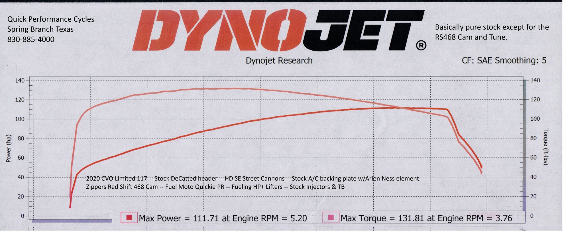

Heat reduction, increased sound.
I don't know the before hp/tq number but here is the after...
2020 117, RS468 cam, stock a/c and stock decatted header, street cannons. 131 to and 111 hp.
