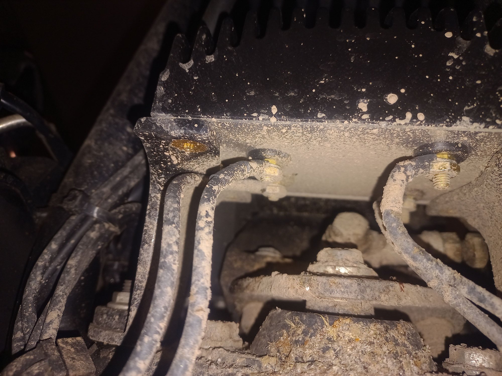

Hello. Do you think I should protect the voltage regulator wires? The Cycle Electric installation instructions didn't mention this. I don't want to cause a short circuit while washing the motorcycle or riding in the rain. I can't find direct contact information for Cycle Electric so I'm asking here.

I haven't messed with a '97 regulator, so I don't know for sure... Is that your OEM regulator?
I suspect the Cycle Electric unit will come with the posts like your OEM regulator, and I suspect the posts are sealed to the inside of the regulator.
IMHO, water shouldn't hurt those connections. I wouldn't worry about it.... looks like those connections lasted a good many miles as is....

Agreed - I have been running a cycle electric alternator rotor and regulator for the last 80 or 90 thousnad miles with no worries (2011 police road king)

This is the new Cycle Electric regulator. It only had 400 miles on it, but the conditions were tough.

I had the same concern when I installed my Cycle Electric regulator. I think I covered the connections with electric tape, but I really didn't need to. It will be fine as it is.

Picture makes it look like you ride on some difficult "roads".
Connections look fine BUT you might consider adjusting and turning the wires on right side of picture so they are towards the right support bracket.
Wires would be just a little better protected if re-adjusted.
After everything is re-adjusted and tight....I would also consider placement of a small amount of sealant on the expose screw threads just to keep nut from backing off.
Perhaps some black permatex RTV or similar...just on the exposed outside thread area.
Remember that sealant does not flow electricity so only apply after installed on that exposed threaded area.
