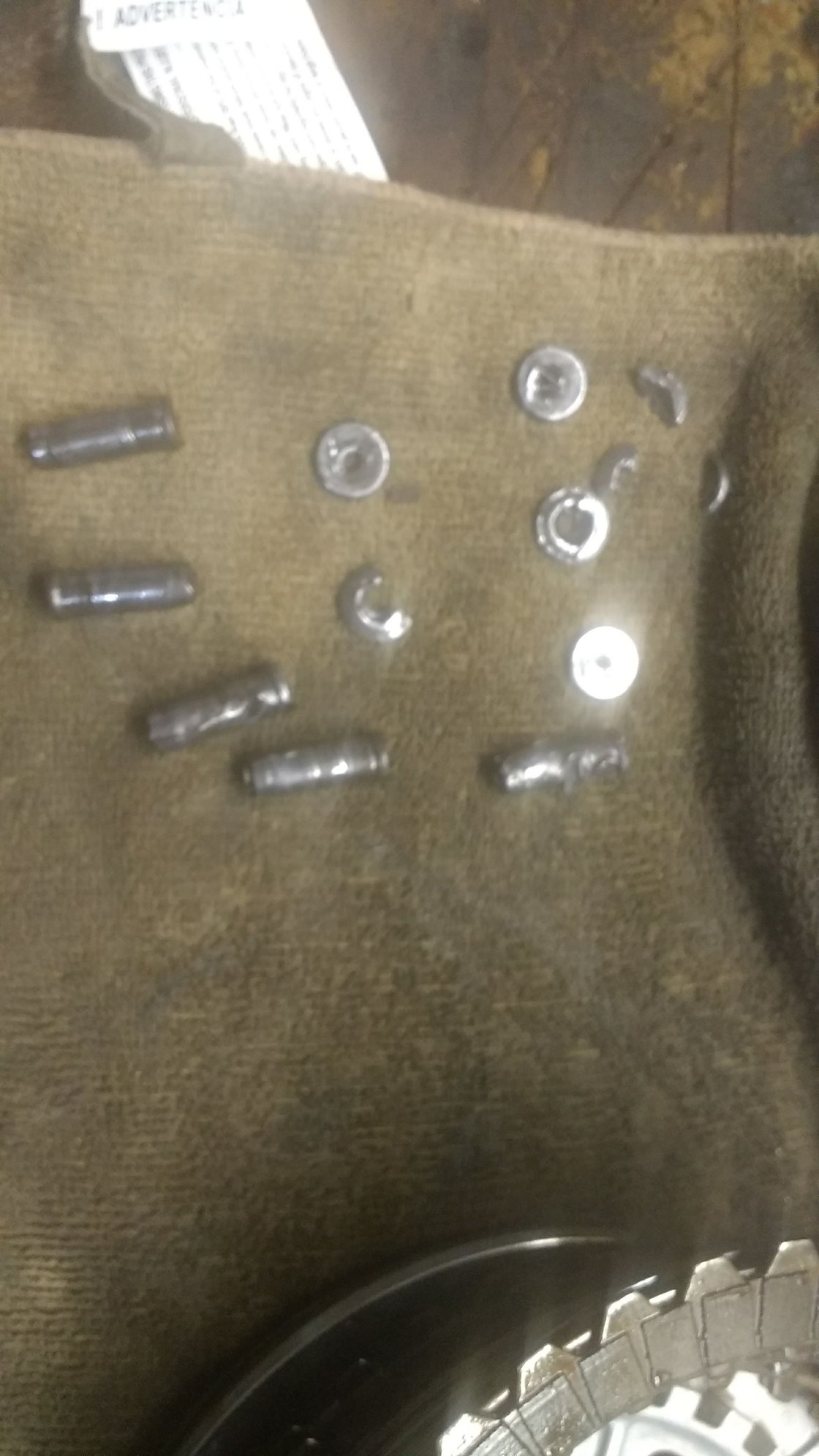

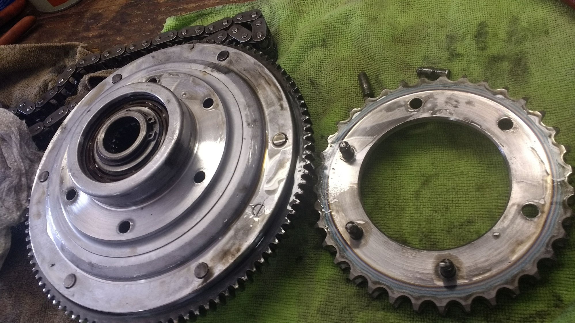

I had a 97 Electra Glide that had 160,000 miles on it.
One day while trying to casually leave a stop.....nothing/no go.
I figured the transmission had broke a shaft.
But when I pulled the primary I found the rivets that held the primary sprocket to the clutch basket we're all broken.
I put an eBay clutch in it on the cheap. 👍
