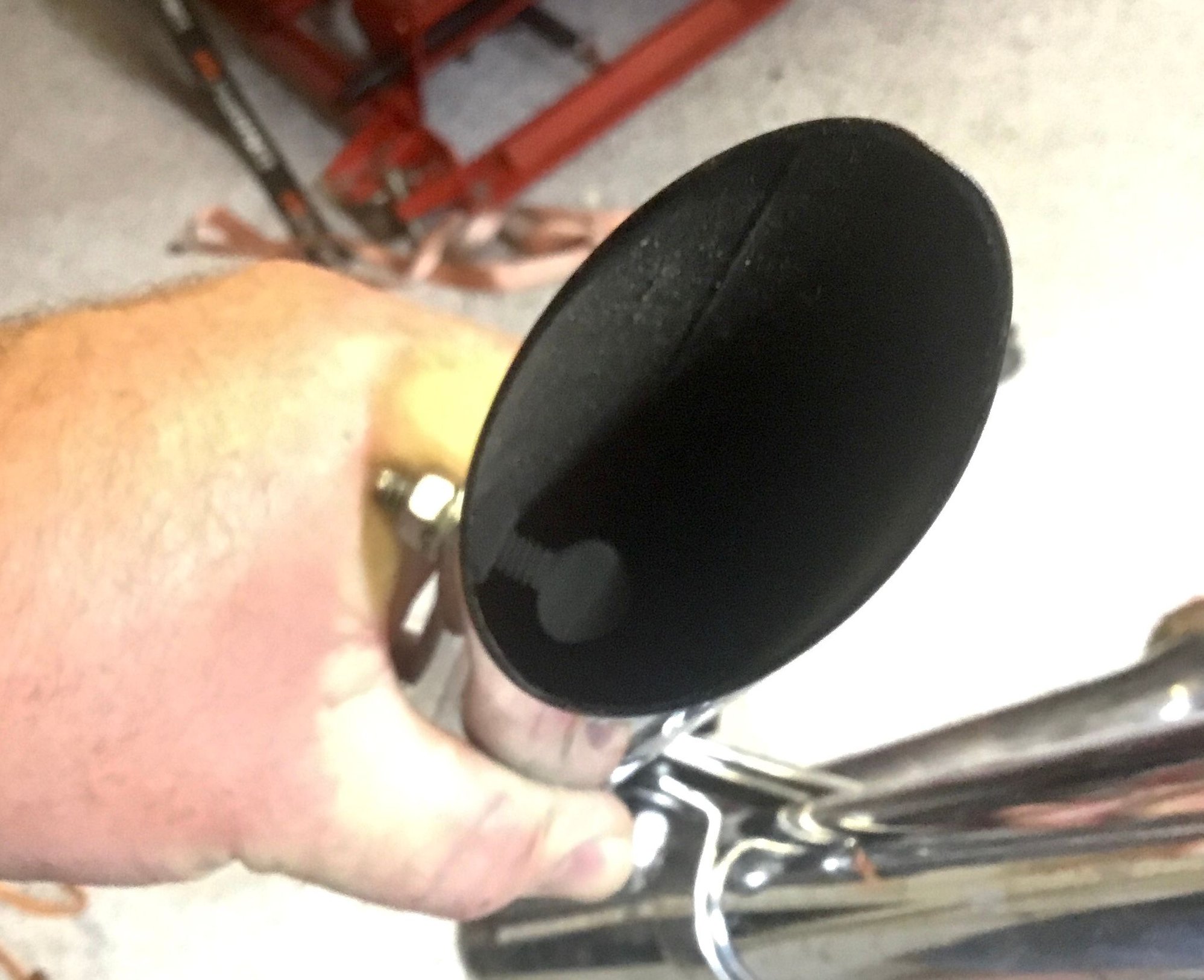

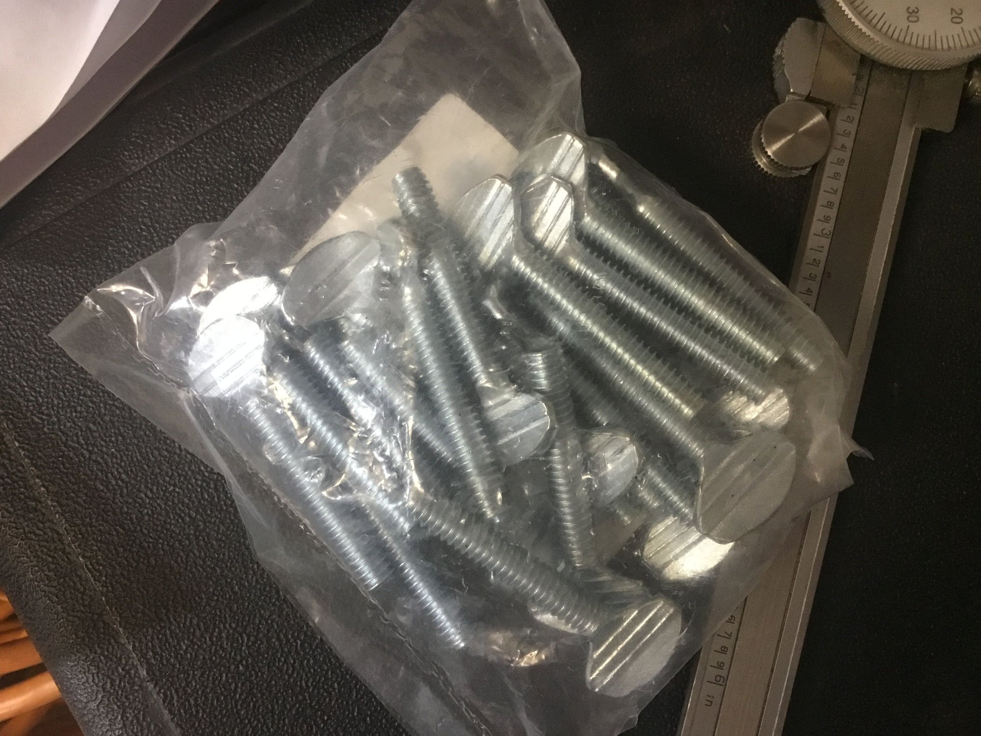

You never want back pressure, or restriction.. that’s a misguided myth. You want to brake up reversion. The bolt trick AKA TTI’s, AKA Lollipops do a pretty good job of restoring most of that dip. Opening up the tails helps too.

Essentially a washer on a bolt

It's DK Customs, not CK. Eye bolt, lollipop, TTI. All basically the same.

I have been doing this for over 30 years.
