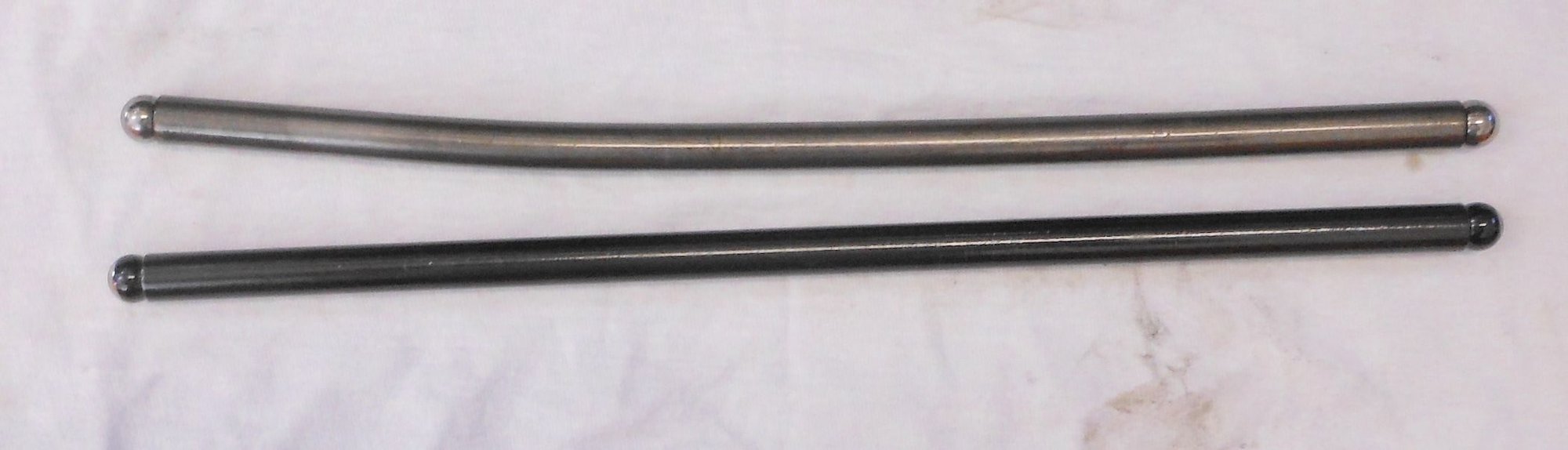

Having said that, I inspected an engine that ran great, but at idle one pushrod tube wobbled a little. This was a totally assembled, running engine. When I opened the pushrod tube, it was obvious there was an issue with the pushrod in the wobbly pushrod tube, that needed further inspection.
I found this:
If you decide to do further inspection, let us know what, if anything you find....
