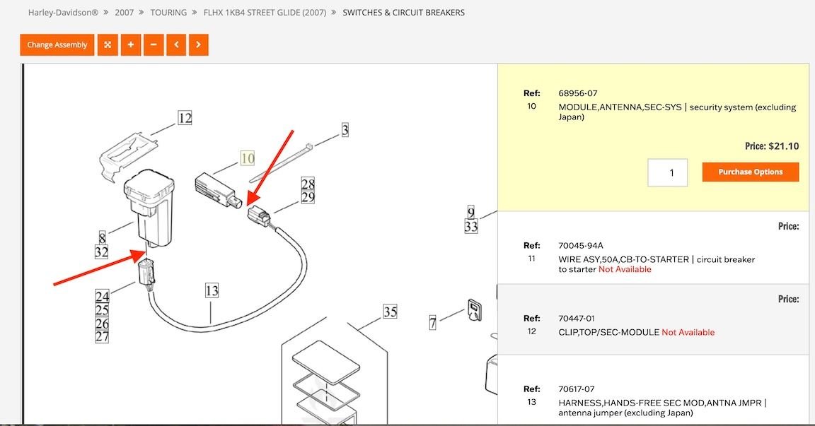

Check that the TSSM FOB antenna, its wires, or its connections didn't get damaged, or disconnected during the trike install....

The antenna is right under the seat nothing was touched there but i will check it out, i'm heading out and will check it right now.

Is there a way to check to see if the antenna is working or the TSSM is working? I just checked the anntenna and the TSSM and see no bad wires. i wish there was a way to trouble shoot them
