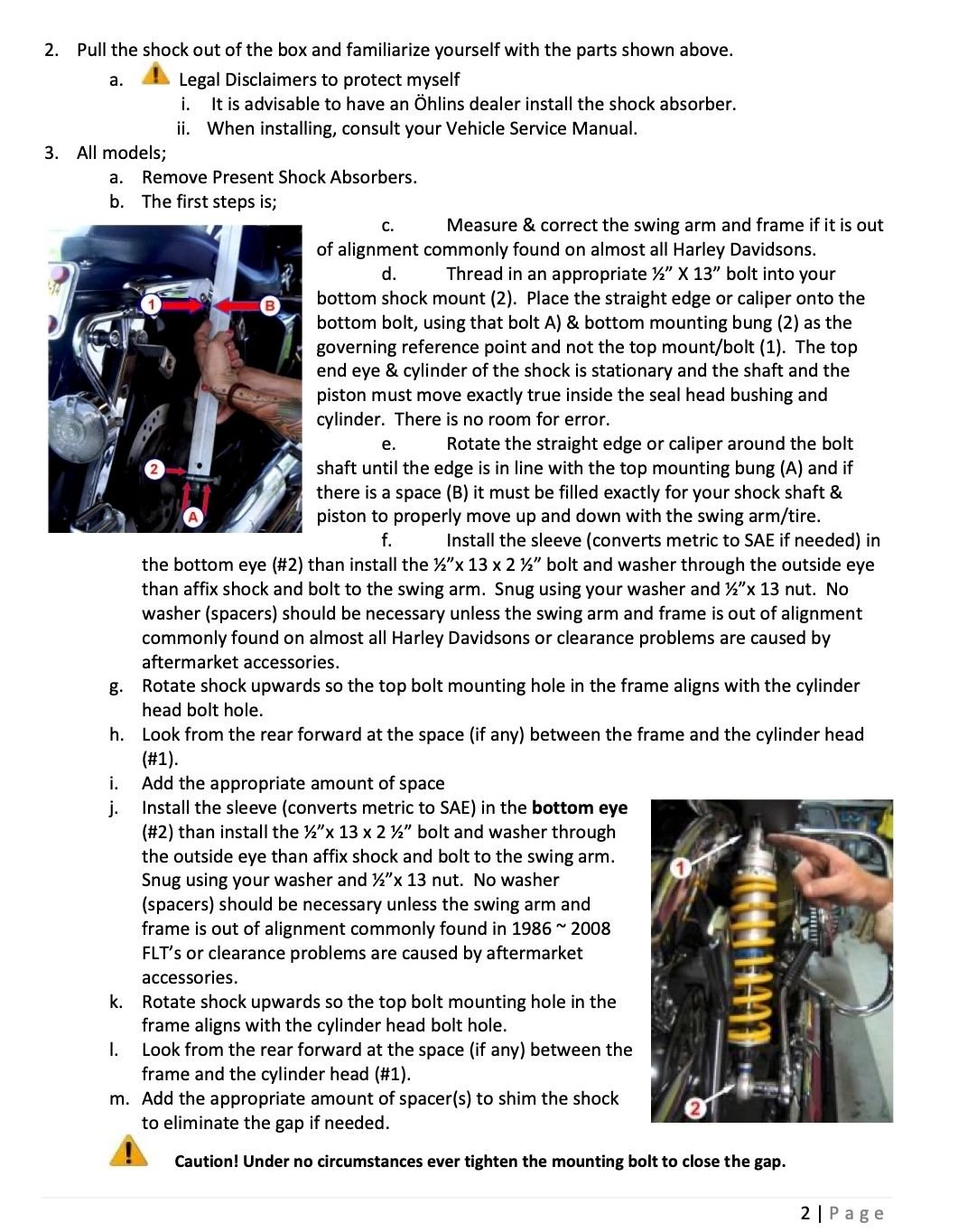

Anyone know how to make sure shocks are properly aligned? Like plumb or vertical or whatever? I remember Howard Messner telling me something about a straight edge and plumb line way back in 2016.
From Howard's "Motorcycle Metal, General Unofficial Mounting Instructions" on page 2.

Good general advice..... but.....
Most motorcycle shocks are not perfectly vertical. So a plum line will not help in most cases. That is why a straight edge is recommended for most motorcycle applications. That will line up the mount holes AND allow you to see if the mount holes are "off" and may need a spacer/washer....
