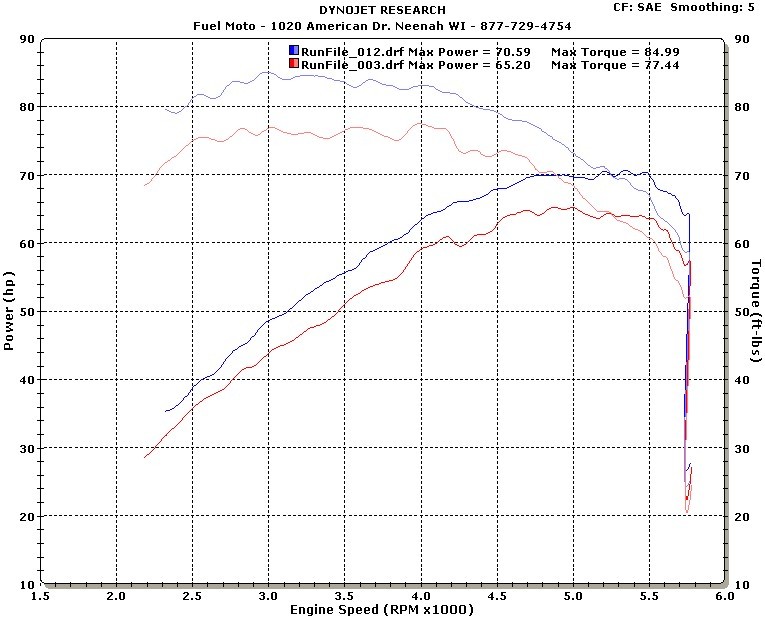

A good set of slip ons works very well on these bikes and there are considerable gains with the Stage 1 air cleaner and EFI tuning. Our Jackpot mufflers feature a unique dyno developed asymetric baffle system and take advantage of the stock headpipes and perform really, really well. We will post some charts in the next week as we will be doing fuel maps for many different combinations over the holiday long weekend. For starters here is a chart from a completely stock 09 vs. our Jackpot mufflers, runs done as fast as Kieth could swap hot mufflers. http://www.fuelmotousa.com/dyno09stkvsjackpot.JPG
