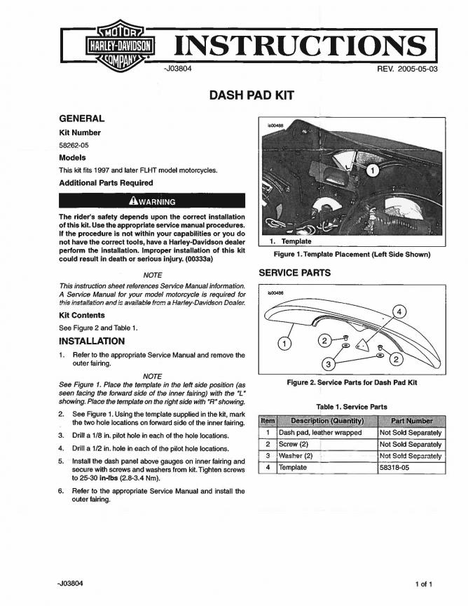

Hoping to find someone who has installed a Fairing Dash Pad #58262-05 and can part with the template, or a copy of. I picked up a dash pad, thought it just stuck on with double sided tape. Turns out there are 2 studs that need to be inserted through the inner fairing. I would like to get a template or copy of since I didn't get one with my pad.

Really ? how hard can it be to do some measuring And drill 2 holes?...

If ya really need it, it is 58318-05 for $2.35

just dab some whiteout or white paint on the studs and set the pad in place and press. its how i did mine and the holes were perfect

+1 on whiteout. Water based so it won't be a long term thing, but will give you the points to mark on the inner fairing.

I have one scanned, PM your email address and I'll send it to you.
After all two bucks is two bucks!

Default Template
Here ya go.
This should help you out.
Charlie
