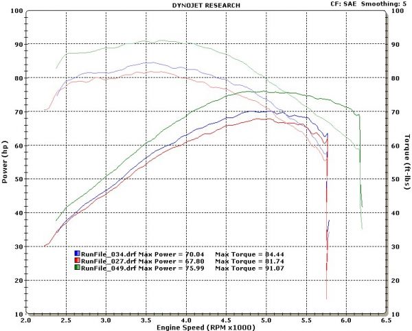

Here is a specific dynochart comparing the following:
Stock 2010 SG
2010 SG with Jackpot PowerTube slip on muffler
2010 SG with Jackpot PowerTube slip on muffler-Stage 1 air cleaner-Power Commander V.
For comparison these runs were done on the same bike, same day, on our dyno about an hour apart.
