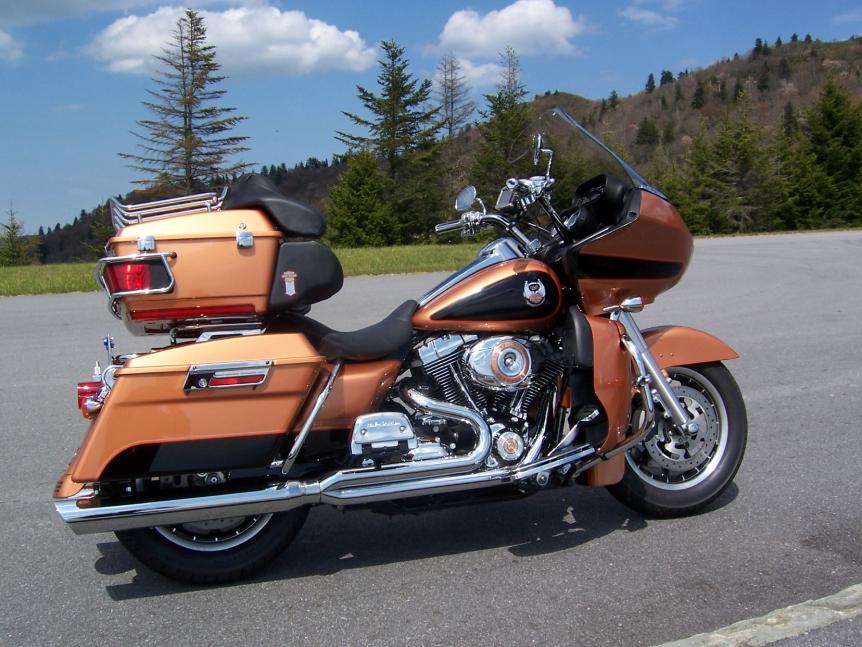

Before you flame me, yes like many of you I have read dozens of threads on these. I think there are many of us that still haven't purchased one so I hope we can get current feedback in a more current thread since many of you have had time to give these things a good test.
Until recently I didn't think I had the need for a stabilizer but after 32,000 miles my bike doesn't feel as stable as it used to though I have not experienced a tank slapper. Also, I road a 2009 EG for a few hours recently and I could feel an improvement in it's stability in curves & turns ... thus my post here.
I'd like to hear from you guys WHICH stabilizer you purchased and IF you really did notice a significant improvement in the daily handling of your bike ... not just in sweepers at 80 mph. I've read where some folks say they can't really tell much difference and some say it rides like it's on rails now. So I am trying to current info for us pre 2009 owners. Thanks all.
