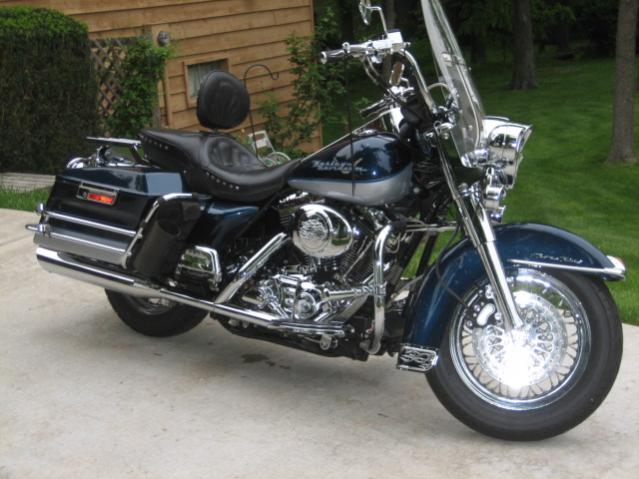

RK High Handlebars 55954-00 8.5" rise. No cable change required. A little weasle dickery with the stock brake lines and your good to go. Changed out to 12.5 chubbs a year later. RK High Bars did not have enough pullback for me (5' 7" 33/34 sleeve) Pic is the Road King High Bars. Signature is 12.5s
