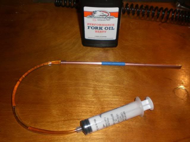

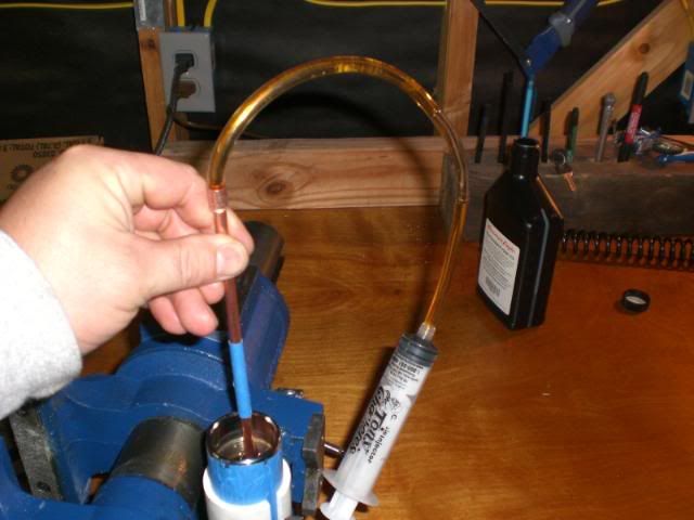

Here's the one I made. I used a syringe from an injectable marinade, some tubing from Home Depot, and some left over copper tubing. I then marked the level with tape so I knew how low to go. It works like a champ and was cheap!

It's not about how much oil is in the fork but how much air is left. Thats what you want to be equal. Motion Pro makes a tool but the home built versions work just as well.
