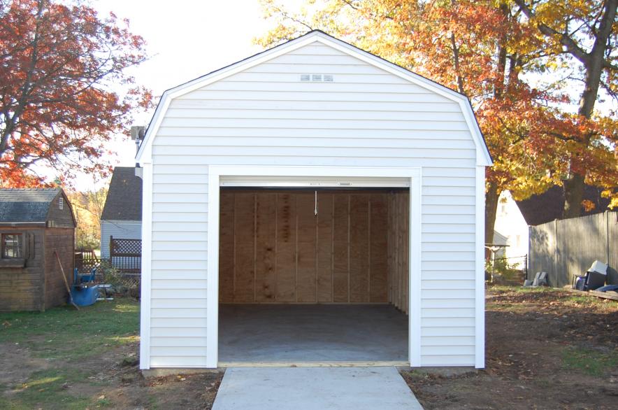

I'm looking to build a garage and would like for it to resemble a barn on the outside. Post some pics if you have something similar. I'm looking for ideas.

I have used no groove T-1-11 and then "battened" the seams then split the space (24" centers) with rough sawn 1X2. Looks great and holds paint like crazy. James Hardy makes a siding panel also but not quite the rustic look.It won't rot or burn, as it is a concrete based panel, good stuff.You could batten this also for the same look.

sumtin like this.
