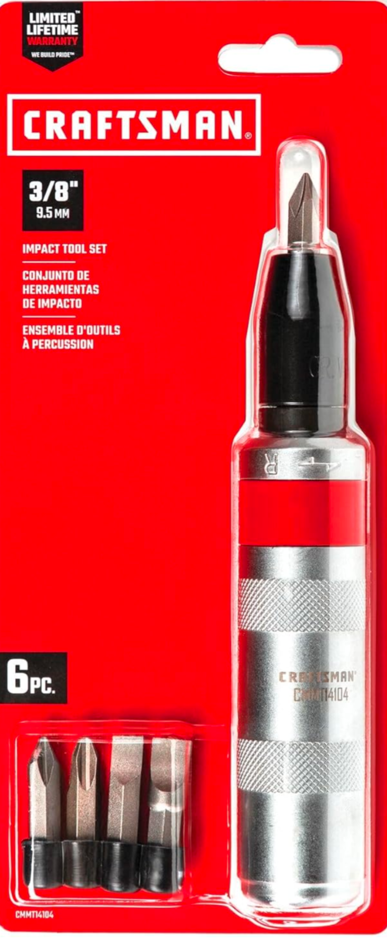

Default Why are handheld impact drivers sold in 3/8 or 1/2 hexes when 99% of impact bits are quarter inch?
Just bought a Craftsman handheld impact driver it's a 3/8 hex (not 3/8 square like for sockets), only came with five 3/8 hexbits.
It was that or a 1/2 hex - again not 1/2 square like for sockets.
But then went to look for a bit kit and they're all 1/4".
I saw no handheld impact drivers for 1/4" bits.
And looking for an adapter all they think you're talking about is 1/4"square drive to 3/8" square drive.

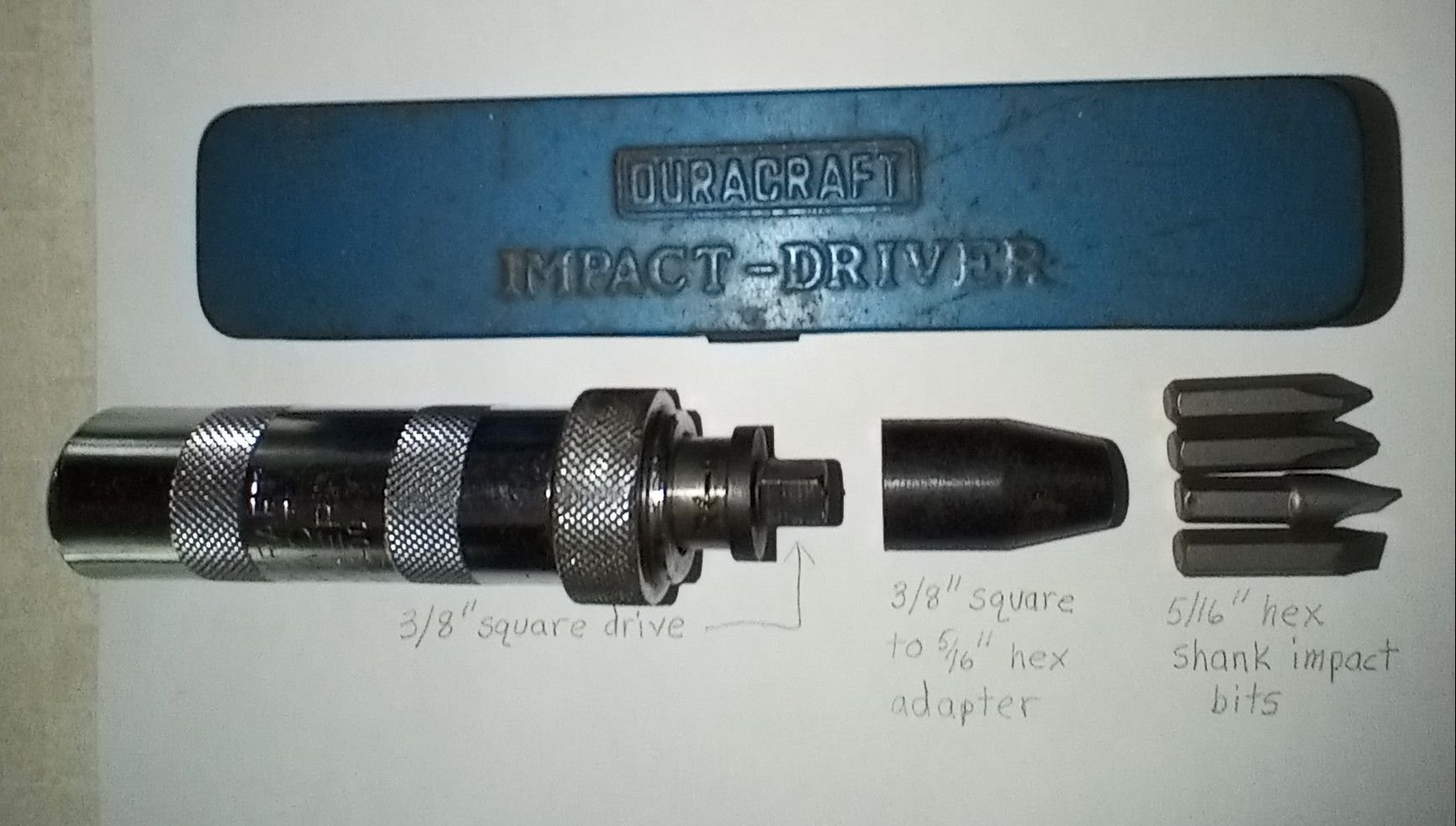

I've never seen or heard of a hex drive hand held impact driver. I've owned this one for many years. 3/8" square drive. It came with a 3/8" square to 5/16" hex adapter and four 5/16" hex shank impact bits. Replacement bits with a wide variety of tip configurations (torx, phillips, flat etc) are readily available.

OK, what am I doing wrong here?
This is what I have, the 3/8 hex bits go in the end which is also a hex.
You're telling me that it unscrews at the end - presents a 3/8 square drive like any socket.
So I can get an adapter that goes from that 3/8 square drive to a 1/4 hex female.
I annoy myself.

The adapter doesn't screw on/off. Much like a 3/8" drive ratchet, the adapter is held in place by a spring loaded ball. Remove the adapter the same way you remove a socket from a ratchet. The tapered end of the adapter accepts the 5/16" hex shanked bits.

Thanks yeah I realized they come off just like a socket after I wrote unscrew.

Another thing I forgot to mention. I would be leery of using 1/4" hex bits unless they're rated (hardened) for impact use.
