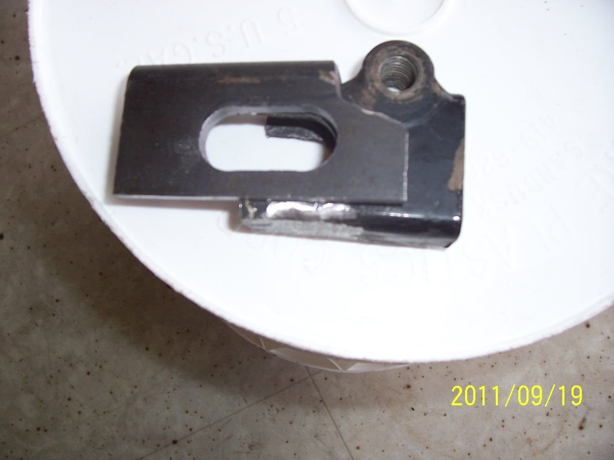

There's one big difference with ride str-8 and yours, the axle adjusters help but you also need to beef up your axle spacers on the inside of the swing arm, if you look at ride str-8 he made new axle spacers that were much wider on the side that touches the swing arm to help spread the torque out and to keep from pinching the metal, I'd look around at a machine shop and see if you could get the spacers made and you should be good to go, I know guys with over 80,000 miles on 01's with ride st-8's design without issues

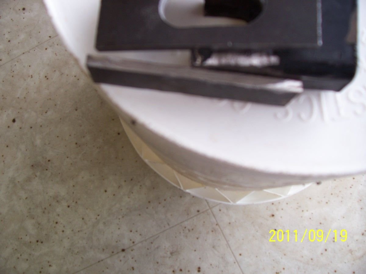

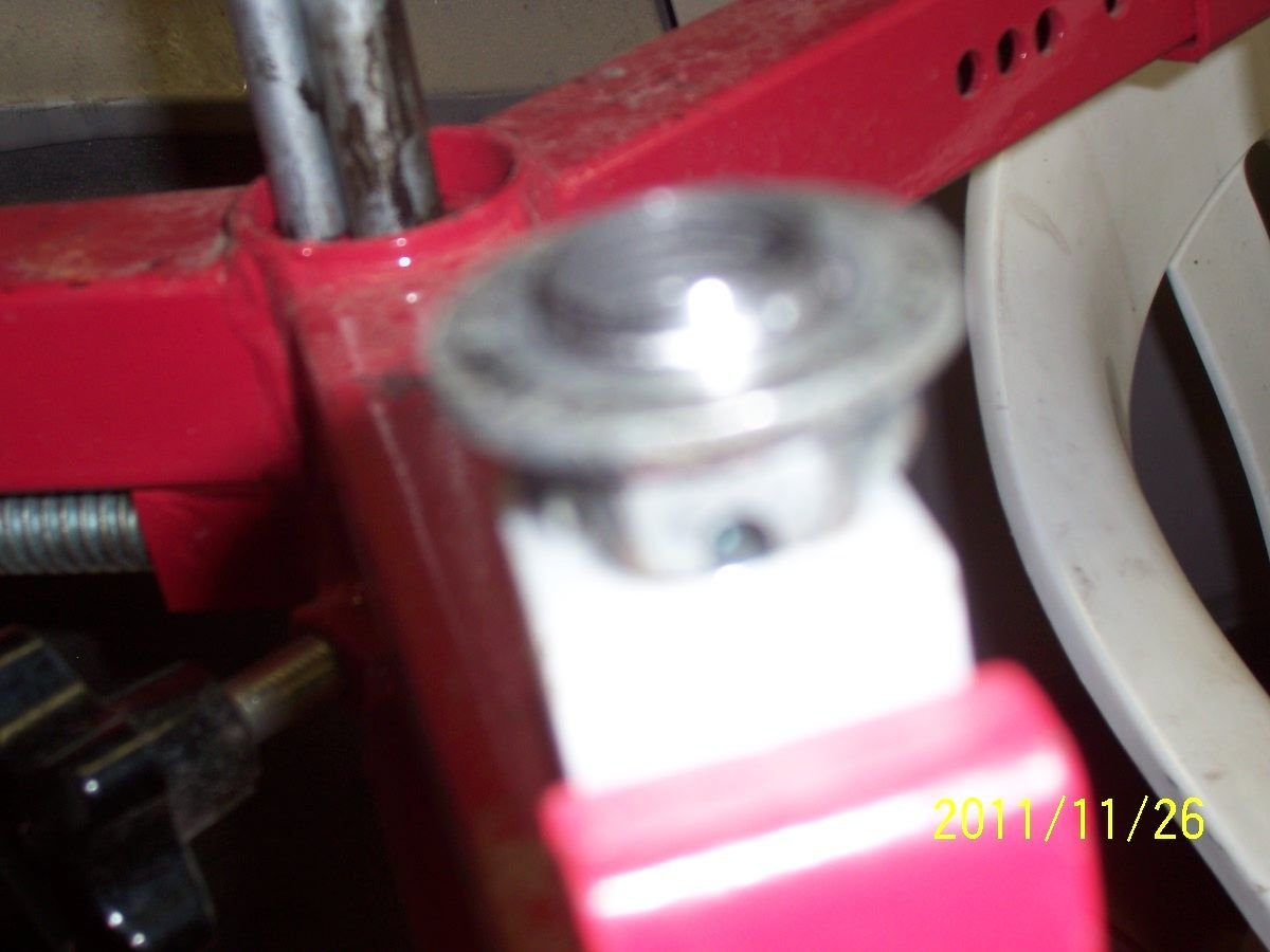

The problem that I found with my 99 Ultra was the axle is 3/4" but the threads are 5/8" putting too much pressure on the inside of the arm & putting at a bind. I had a machinist machine down the nut (looked like a lug nut for the older mag wheels that had a shank go through the wheel)
I also beefed up the swing arm
Which I still have. I am in the process of going to a modified 2008 swing arm to run a 180 rear tire. So if anyone wants it, 20.00 plus shipping.
