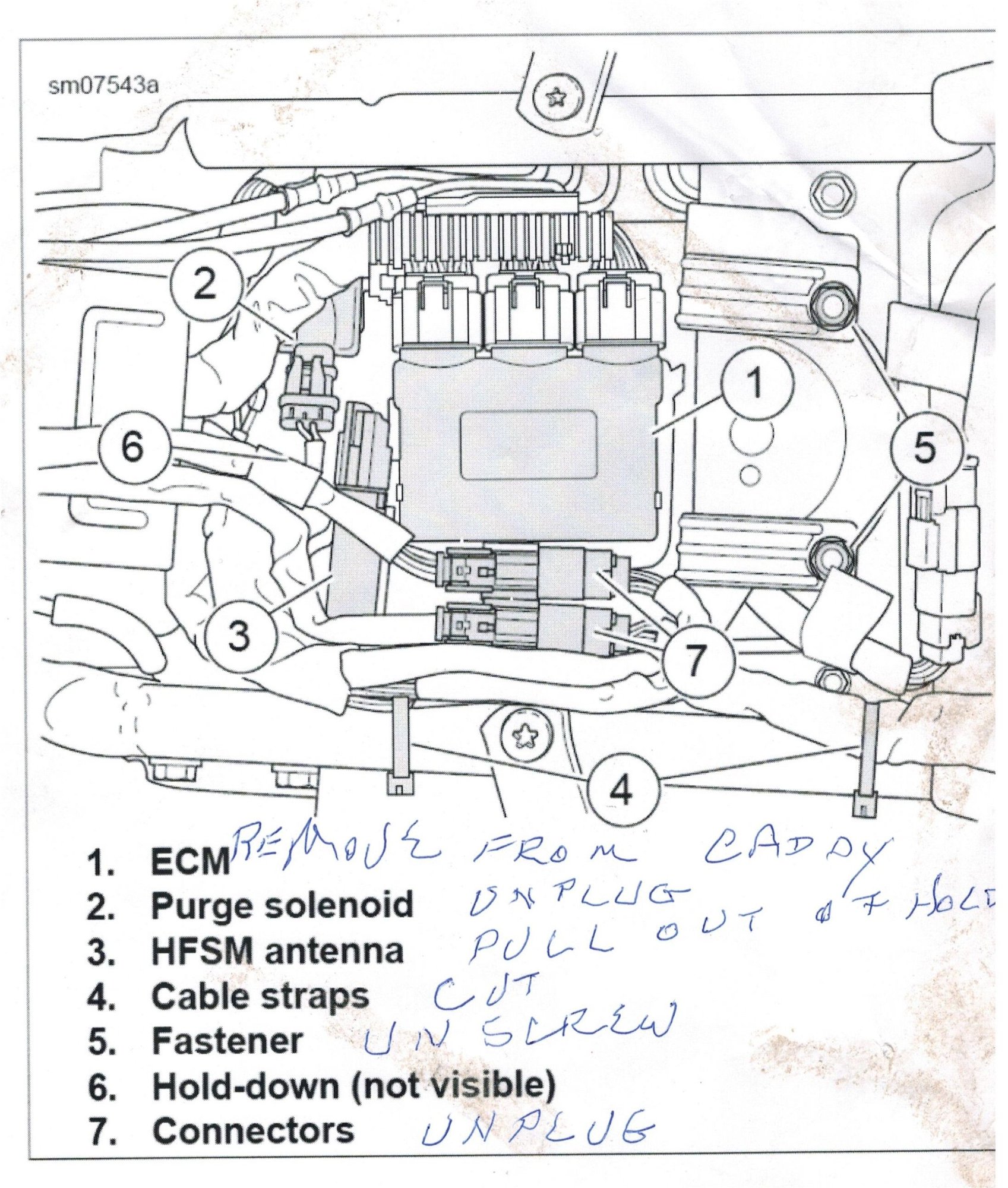

First off i am somewhat mechanically challenged but this is what i figured out.
sorry for my hen scratch. After removing the seat and the 50 amp fuse i did the following.
1: Lightly pry off ECM from caddy
2: Unplug #2
3: HFSM antenna. It looks like a plug but it is just sitting in a rubber holder. This is where i was making my mistake. It has to be pulled out along with the rubber holder. Once it is out the caddy can easily be removed from over the battery after you unscrew #5
4: cut the cable straps
5: unscrew caddy holder
6: the hold down may not be visible but can only be done after your remove #3
7: unplug 7's
Hopefully i said everything correct.

I can remove the battery without cutting the 2 cable straps(4).
