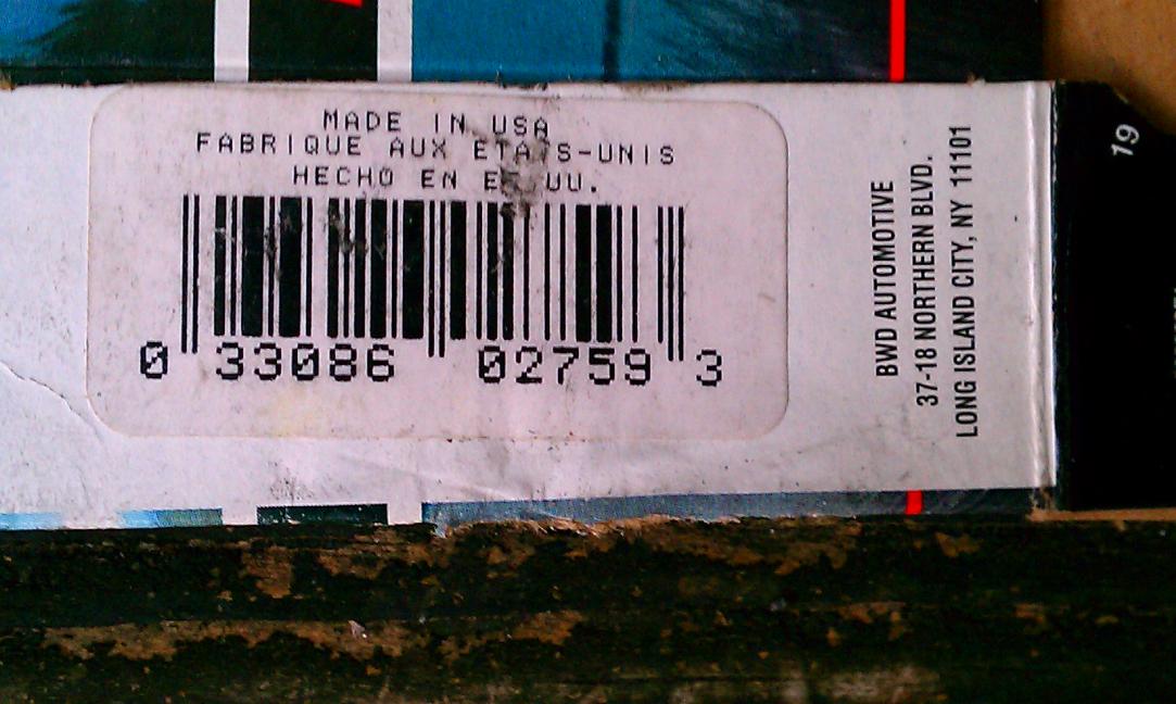

Here it is easycruzer

actual pic of switch installed
